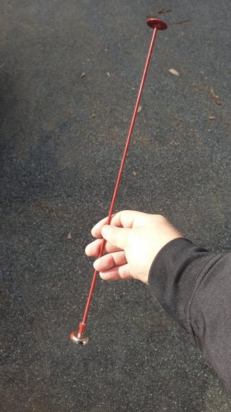

    I just recently started using this method as well, it's super easy and fast.

    I made one like that also, it wasn't terrible but I lost the wing nut so I decided to try something else.

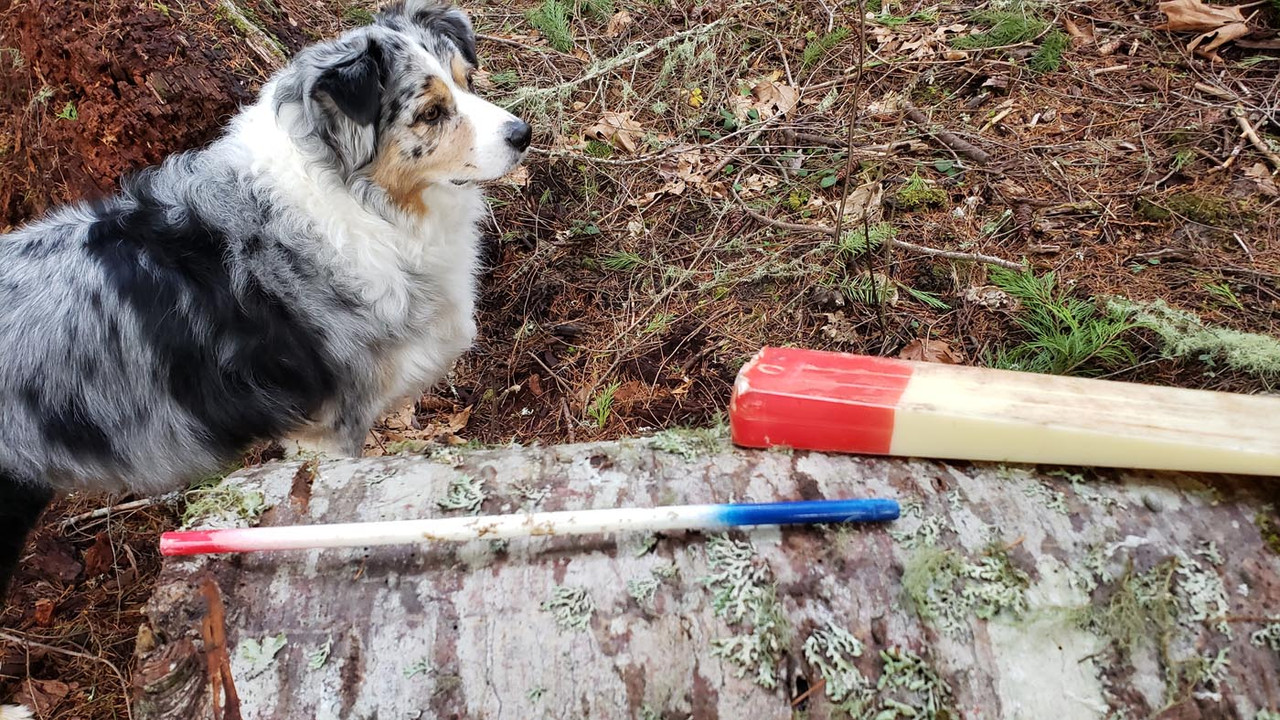

    Marking stick = Measuring stick? I learned to hold a measuring stick in my left hand with the saw handle while bucking firewood. So it's hold the stick on the log using my left, mark the spot by eye, grab the saw handle still holding the stick, cut, repeat. It's an odd process when you start out using it then it becomes natural to hold it with the saw and move along quickly. No marks are made.
    Edit: Yep, I measure just like FarmerSteve. Same saw too.

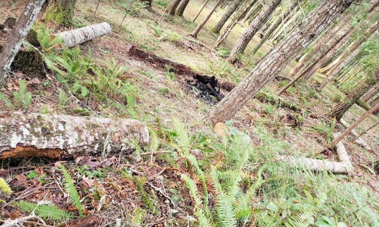

    Since I'm retired and am only cutting my own wood, mostly on my own land I have the luxury of taking my time and making the very best cuts I can. On the other hand, when I was learning to be a timber faller it was "ALWAYS make the best cuts you can, as practice for when you really, really have to be precise. (And your stumps are a record of your ability anyways - period.) The phrase often heard is "Stumps don't lie".

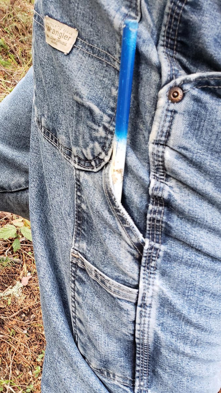

    I have a couple of these sticks, they are fiberglass and painted so I can find them if lost.
    They fit in my side pocket too. They are only 12" long as I cut wood for North - South lay in my woodstove. (A huge advantage in my opinion.)
    And I am cutting conifers so I have really nice straight timber to make consistent firewood with - impossible in an Oak grove.
    Wood like this makes for nice stacks, but it is low in BTU's. (mostly Douglas Fir and Silver Fir)

    Love that doggie! I had an Australian Shepherd until I had to put him down last year and that almost killed ME.
    Yep, measuring stick is better than marking stick, lol. And I actually used your method just yesterday when I cut a hickory stick 16" and used it. And my khaki pants have a pocket like that!

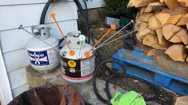

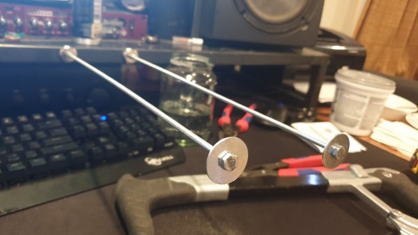

    That's basically what I made. Nice strong magnet. Threaded 1/4" rod. Nuts at the end with a washer. Set to 16".

    That looks great except I wonder does it get the way when bucking larger logs. Appears to be fine with small diameter logs. (The video I saw the guy made his actual bucking cut with it on, near the butt of the bar. Doesn't seem that that will work for larger diameter.) Just wondering. I've been using a hardwood stick with ends painted red lately, lol.

    No, you mark the log first and then you take it off.

    Yes, but that is not what I saw on the promo video. It would seem there is simply going to be a diameter limit but he doesn't appear to be marking first... video on the site page...
