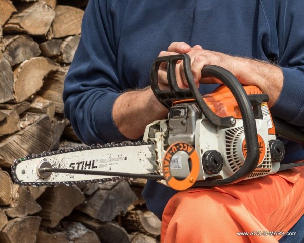

    This has been covered several times already, however I tried multiple different methods over the years before settling on the magnetic Firewood Buddy (used to be sold on eBay for cheap) and the fixed 16" Accu-Mark (as shown below). The end of the Accu-Mark is a bit flimsy, but it has held up well enough over the last couple of years. Like Aje1967, I've left mine behind a few times in the woods, however luckily, I have always been able to find it again.
    ACC-U-MARK Firewood Marking Tools – ACC-U-MARK FIREWOOD MARKING TOOLS
    There is another magnetic marking tool for sale on eBay (similar to the old Firewood Buddy) however I do not have one of them so cannot vouch for it:
    Firewood measuring tool | eBay
    My Mingo Marker has been collecting dust for several years.

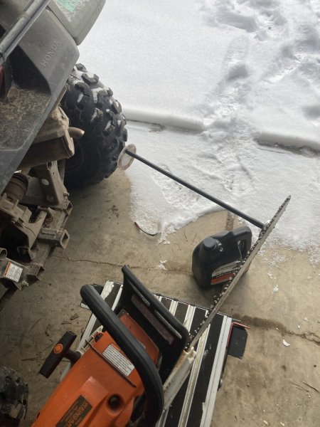

    Made a couple of my own based off the accu-mark.

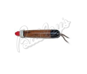

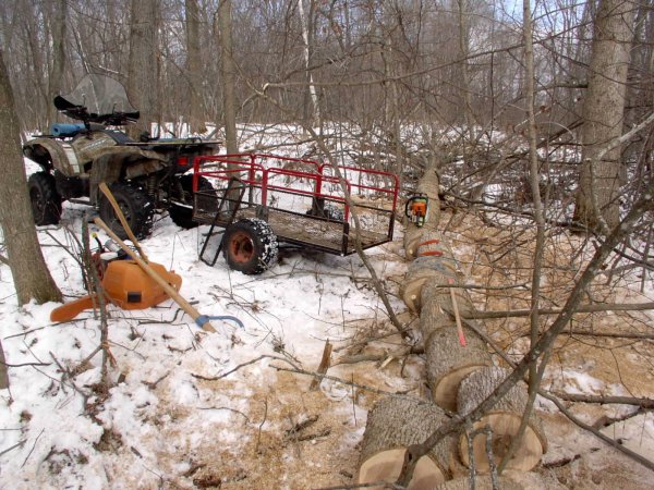

    Below you can see one of my marking sticks. I usually use a 48" stick (it can be made from about anything you have laying around). I need 16" so the 48" gets me 3 marks. I use a lumber crayon and to keep it from breaking and to keep from losing it I put it in a crayon holder. It is simple but works nice with one exception. When the wood is wet marking doesn't work great so then I simply draw a mark with the axe rather than the crayon. Chalk can work too but breaks easily.

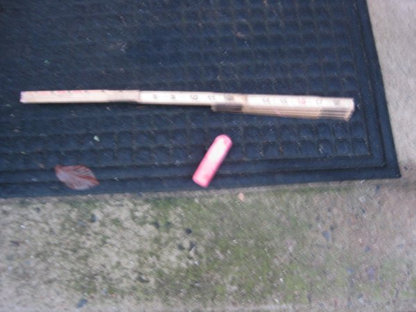

    Was using folding rule and chalk yesterday. I too cut 16" so stud markings are used. The worn out one from work gets demoted to firewood duty. If i see them cheap at tag sale or flea markets ill buy them for back up. IMG_0091.JPG
