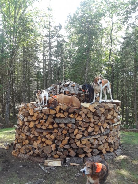

    The girls are showing off again:D

    That’s awesome

    dave, you continue to outdo yourself :yes:

    I know dogs can fetch, but the fact youve trained them to make nice holzhausens is absolutely amazing!
    Can you train my cat to do that!

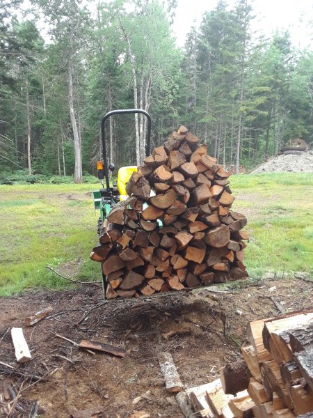

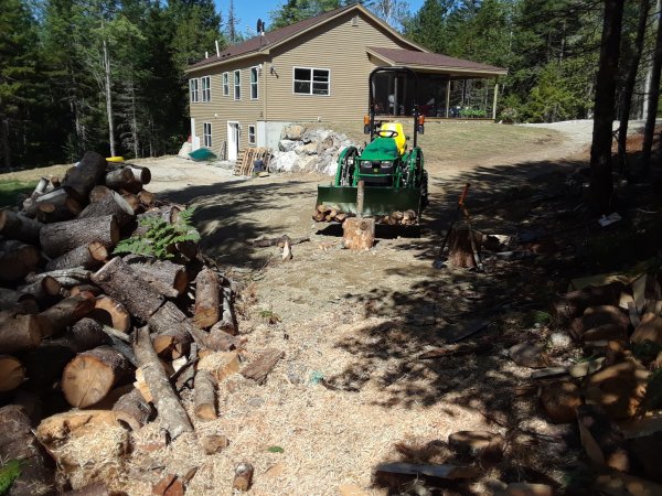

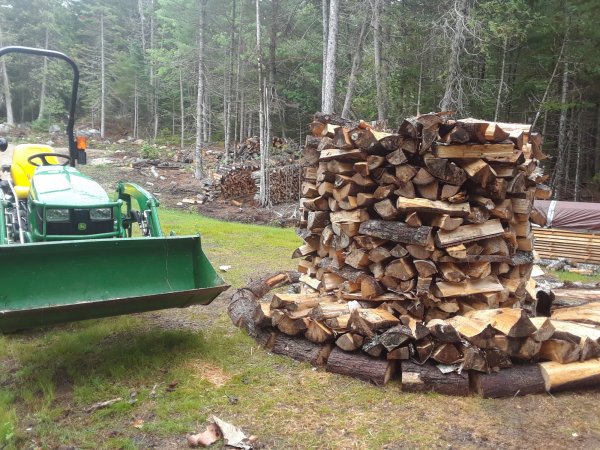

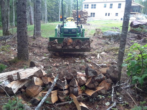

    One of the Hounds had a vet appt in the middle of the day, so I took the whole day off, got some more hauzen work in.
    Well Seasoned might notice a few rain drops on the hood of the tractor:whistle:
    Got most of the second row done and the roof started. The inspectors came by to take a look this afternoon.

    Nice work Dave! Love the tractor load and hauzen'n with the hounds!:yes:
    Not really seeing many rain spots on the hood, but maybe it's because either it hardly rained or my screen is small :D
    Keep the pics coming! :thumbs:

    Keep the splits slanted toward the center or at least level. Stacking on a radius, especially on a smaller radius, the inside edge gets high and the stack starts to lean outward and you lose stability quickly. You end up using shims placed on the outer edge to get the stack back level or tilted inward. I laid some small sapling pieces on the ground with a smaller diameter piece on the inner ring and a larger piece on the outer ring to establish the inward lean at the ground. This problem gets lesser the bigger the radius. You end up always laying the fat end of a split toward the outer edge, to help maintain the inner lean.

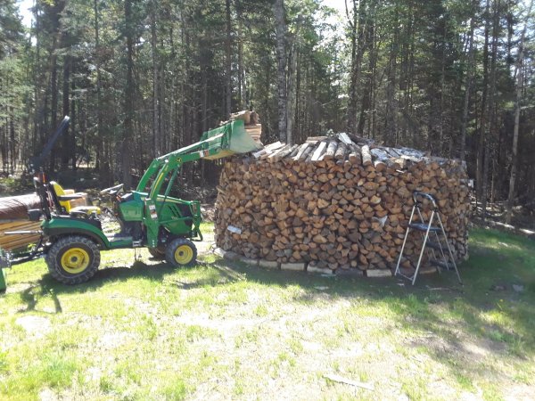

    Just about finished up today, a few more splits to add to the roof yet, ended up 16 feet in diameter, three rings of splits, the sides are 5.5 feet high. This wood will likely be for winter of 23/24.
