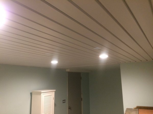

  18. ironpony
    ironpony
    3,730
    20,625
    Mid Ohio
    that was common for a while it created an envelope of conditioned space upstairs and unconditioned downstairs. If the basement is unconditioned it makes a huge difference in heating / cooling.

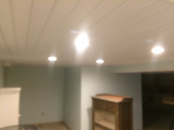

  19. ironpony
    ironpony
    3,730
    20,625
    Mid Ohio
    this is why my solution to basement ceilings is exterior soffit, no loss of headroom and easily accessible if need be.

  20. brenndatomu
    25,054
    162,687
    How do you attach it so it easy to take down as needed?
