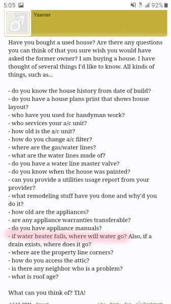

    What are the taxes?
    What is the annual cost of heating?
    What is the annual cost of cooling?
    What is the annual cost of water/sewer if city supplied?
    If it has a well, be sure to check the water and also how well it flows. Turn water on and let it run for several minutes especially to make sure pump runs and can keep up.
    Talk to neighbors. For sure I would never want to buy next to a family that wants to listen to loud music or has dogs that are constantly barking. Especially those dogs people tie or put outside in a pen and then they bark for hours on end.
    I also would not wish to live on a heavily travelled road and especially if it had truck traffic or lots of motorcycle traffic.
    etc, etc.

    I didn't read everything. I'd ask to see the utility bills.

    If the water heater fails, the water will go down.

    I didn't meet the people who owned my house before me. My county assessor has a lot of stuff available online like sale records, taxes, and even a floorplan. When I first looked at this place, the neighbor was outside and he answered some questions for me about previous owners, reason for sale, builder, general feel of the neighborhood, etc. When I met him I also knew he would be a good neighbor.
    The previous owners' agent gave my agent an envelope with appliance manuals and a sketch of the septic tank and drain field.
