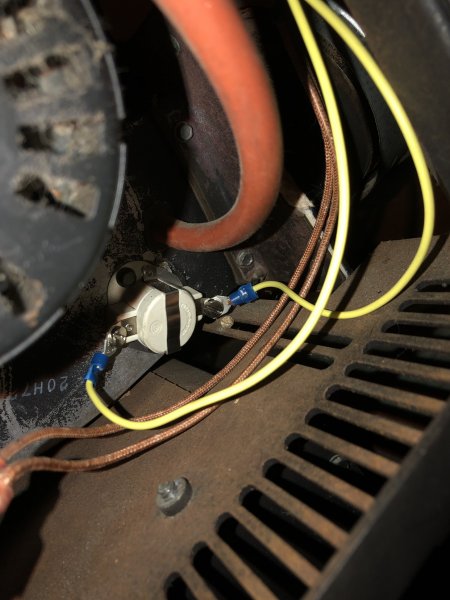

    Did you do the eye Bypass surgery with the new Snap Disc? Pics would be really nice??

    I will post pics as soon as the part comes in from east coast hearth. The one I got from granger was way too small.

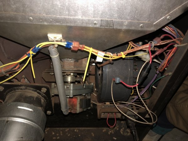

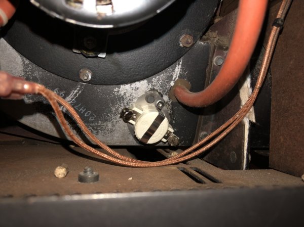

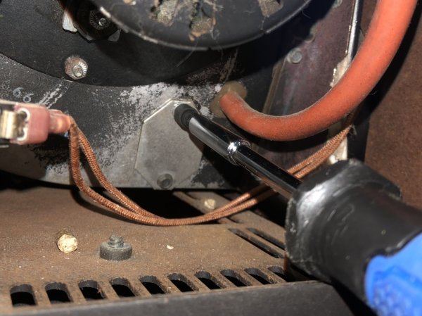

    As promised here are the pics of a completed job. Now the only issue I have is it keeps tripping the surge protector idk why but I’m frustrated now lol
