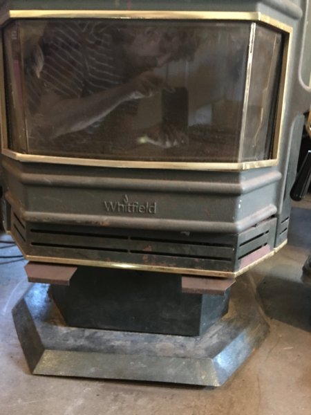

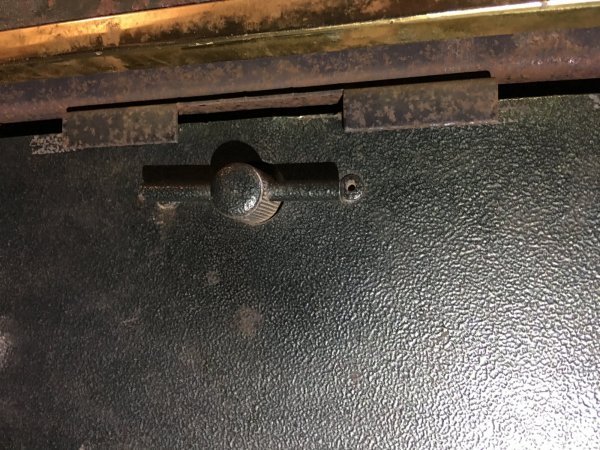

    I am working on this Whitfield Advantage III.

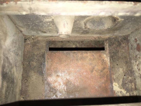

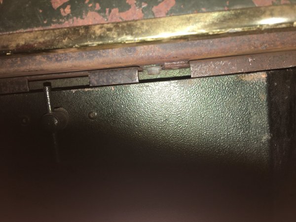

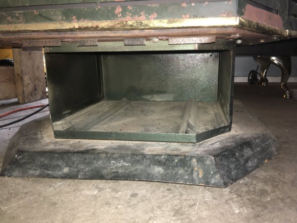

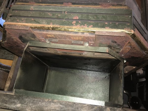

    The large ash pan does not slide out because it hits the ash dump tabs. The right one more than the left on but especially the center ash dump tabs for the ash dump under the burn pot!
    Nothing obviously wrong is standing out here?
    Does anyone know how to fix this?
    See pics
    1 - Stove
    2 - Ash Pan hits tabs on center ash dump
    3 - Stove with ash pan removed - Had to pry it with a screw driver to get it out!
    4 - ash dump under burn pot
    Note: Ash dump under the burn pot does not close all the way like the left and right side dumps do. Therefore the ash pan must be behind these tabs to close all the way!

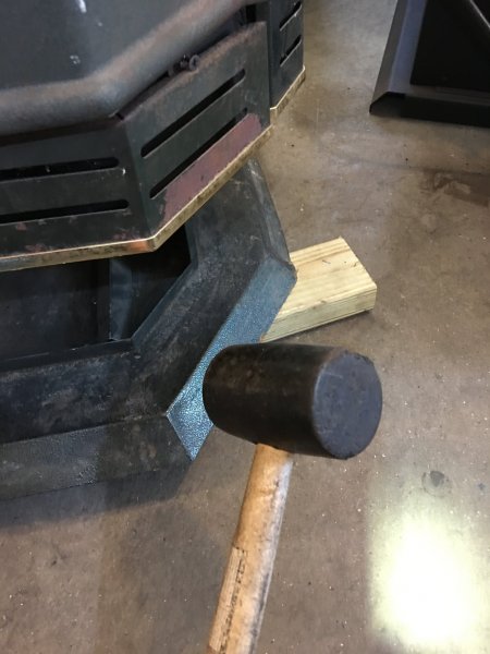

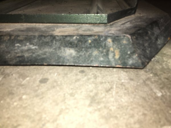

    I think I see the ash pan removal problem!
    The front bottom right side of the pedestal of the stove is bent up which in tern makes the top of the ash pan to high and hits the ash dump! See pics. :)

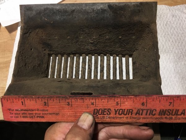

    I just checked the burn grate in the stove. It is the 13 bar 6-7/8” wide burn pot not the 10 bar 5-1/4” Burn Pot! That means it is the Advantage Plus!
    These grates only fit the Quest Plus, Advantage Plus and Cascade!
    I also learned that not all Adv Plus stoves came with the Igniter. However all the Adv Plus stoves come with an Igniter tube! This stove has the dummy tube. The Igniter will screw into the dummy tube but how does that front cap come off?
