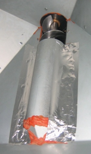

    Yes, pretty normal for a lot of stoves. A lot of people have "polished" the hopper walls, put smooth foil tape in corners, sprayed furniture polish and buffed out, wax, etc, etc. I used to put the alum. foil tape in all the corners to help the pellets slide. One member even put an old, unused cell phone set to vibrate in the hopper and sent calls to it to shake the pellets down.
