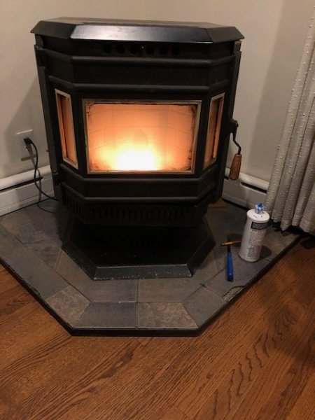

    Update - I installed the new fan, fired up the stove and still have a faint smell in the back of the stove but it is NOT smelling in the room and NOT making soot on my furniture and seems to be burning properly so I am letting it go . . . Sending a photo. The glass is a little dirty so the flame looks a little different in the photo than in reality, plus I am a terrible photographer! Thanks to all of you for your support. You are awesome and I am warm and cozy again!

    If you can still smell smoke, there is still an issue.

    Robyn what is that black edging on your hearth? I have a similar one and two attempts at wood have been stepped on or broken otherwise, your's looks nice.

    I don't see a surge protector for the stove, It would be wise to get one. Here's a recommended one

    Not sure what you mean. Where is the black edging you are referring to?

    She's asking about the black edging that goes around the hearth ("base") that your stove is sitting on.

    The hearth "Frame" is likely a steel angle
    Most commercially produced hearth pads use a steel frame.
    A couple pix
    1/8" X 1-1/2" X 1-1/2" Steel angle (A common material used for the frames of hearth pads.
    ivanhoe and wildwest like this.

    Yes, it is angle iron
