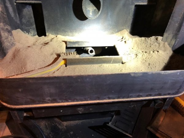

    OK, I couldn't give up and let all of you down! I assumed the repair guy had thoroughly cleaned it but decided to check. I took the baffles off an found this much ash behind and above and around them! I have never taken the baffle off before so I guess I have been very lucky! I also noticed the inside was very black and began thinking it was the hamer hot ones. The pellet stove place told me after I bought them that they did not recommend that pellet for my stove. I cleaned it out as much as I could, brushed the air intake and tried to get as much of the burned stuff out of the burn chamber as I could. Turned it back on and and I haven't noticed a smell yet! Its only been 10 minutes so holding my breath! Thanks to all of you for your perseverance and not letting me give up cuz I was ready! I have 3 tons of hamer hot ones so I will try them again to rule them out once I am sure I fixed the problem. I will be making a trip to the pellet store with my photo and I will be very pizzed!

  6. wildwest
    30,643
    144,560
    WooHoo Robyn!!
    ivanhoe, imacman and PelletHound like this.

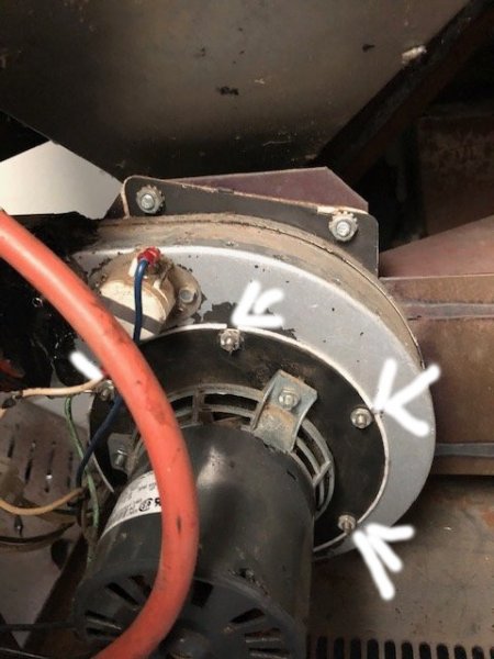

    I am not sure what you are saying. Here is a picture. Can you tell me which bolts you want me to remove? Will I need a new gasket if I do this? Also once it is removed, can it be tested to see if it is running at full capacity? My neighbor is a mechanic . . .
      File size:
      57.4 KB
      Views:
      7
    slvrblkk and ivanhoe like this.
  20. Snowy Rivers
    Snowy Rivers
    Nov 15, 2015
    2,849
    12,491
    Newberg, Oregon
    Here is your piccy marked up.
    Remove all the nuts around the fan plate. (6 nuts total)
    As the gasket was just replaced...just be easy on things when you remove the fan and the gasket should be fine.
    Get a few spares as cleaning this area is needed from time to time.
    Yes...you can run it.
    If you leave it plugged into its harness you can sit the fan motor so it can be observed and then start the stove up (Press start with switch set to draft fan only) you don't need the thing feeding pellets.
    Allow the fan to run for a bit.. 5 minutes maybe
    It should whiz right along at a good clip.
    If it starts slowing down and getting sluggish then there is an issue.
    Be careful while working around electrical connections...there are several spots in the cabinet that you could touch HOT WIRES...BE SAFE..
