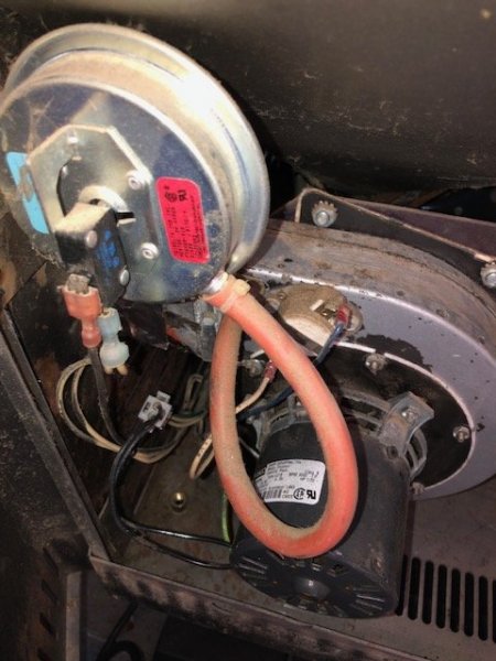

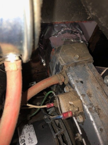

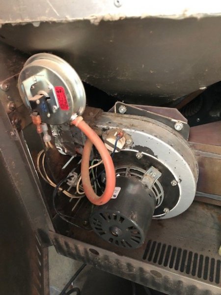

  18. Robyn
    Robyn
    Nov 7, 2019
    45
    123
    CT
    Pipe.jpg Blower.jpg Inside.jpg Blower 2.jpg Blower 3.jpg Pipe.jpg Blower.jpg Inside.jpg Blower 2.jpg Blower 3.jpg
    Here are photos. I will try the laser trick tonight. I assume the guy oiled the fan when he cleaned it. The store is a very reputable pellet/fireplace store called Deans Stove and Spa here in CT. Let me know if you see anything funky in my pictures and thanks to all of you for your support!
  19. imacman
    imacman
    Oct 23, 2013
    6,586
    27,306
    Denver, NC
    A regular flash light and a dark room while stove is running will work too. Best time to look is during start-up while pellets are starting to smolder.

  20. Robyn
    Robyn
    Nov 7, 2019
    45
    123
    CT
    Here is one more picture of the back side of the exhaust blower where it connects to the rectangular piece (sorry, don't know the name for it) that eventually connects with the exhaust piping. If you look carefully you can see a spot where it looks like there is possibly a gap. Is there supposed to be gasket material there? Can I silicone it with high temp silicone?
