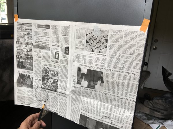

    1. Use newspaper for a template
    2. Trace and cut
    3. Drill screw holes
    4. Paint and install

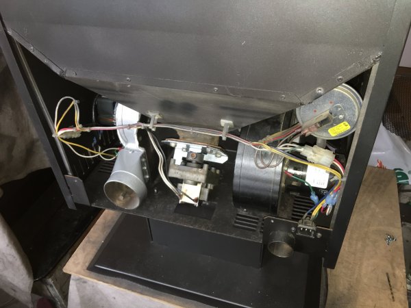

    Pic 1 - No Back Panel

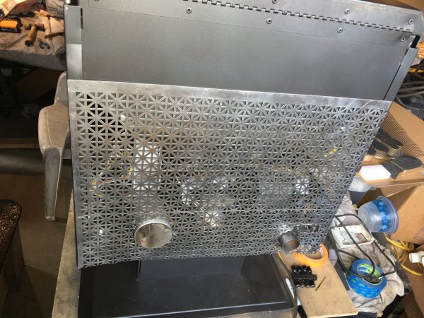

    Pic 2 - After cutting newspaper to overal size, tape on stove and trace vents and AC plug holes

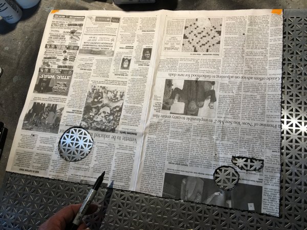

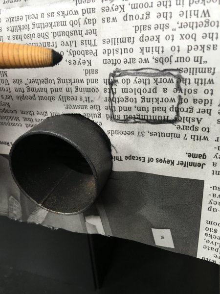

    Pic 3 - Use grease pencil to trace holes on newspaper
    Pic 4 - Then tape on metal sheet and use black magic marker to trace holes on metal

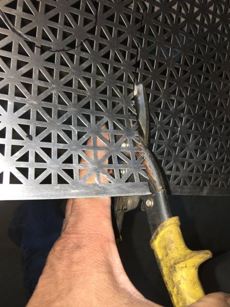

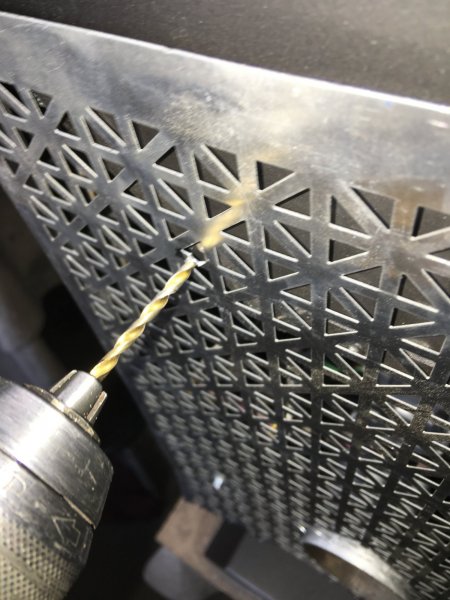

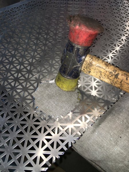

    Pic 5 - Cut metal with sheet metal sheers

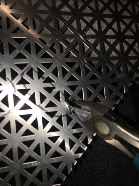

    Pic 6 - Use wire cutters on small holes and cuts in sheet metal
    Pic 7 - Hammer metal flat when done with a rubber hammer or mallet

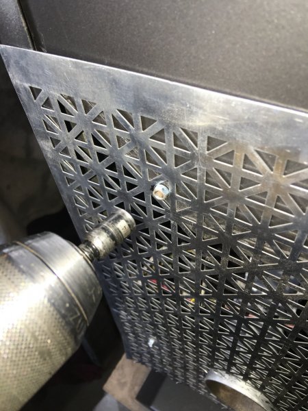

    Pic 8 - Drill out mounting holes

    Just a few more pics
    Pic 9 - Use #8 Self tappers with hex head to check for fit.

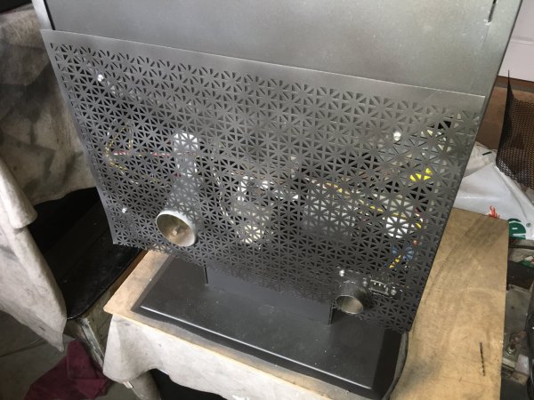

    Pic 10 - new back panel

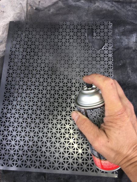

    Pic 11 - Spray 2 coats of hi temp paint that is the same color as stove. (Charcoal color in this case)
    Pic 12 - New panel all done! Nice pattern and good ventilation!
