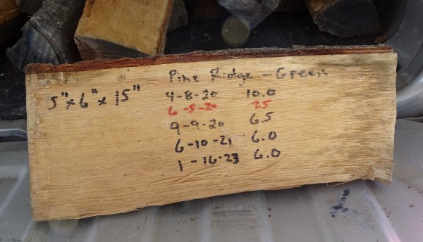

    As a follow up to my previous reply, was grabbing some oak from the stacks to take to the cabin and came up on this piece. I usually mark and weigh one or two pieces in a stack to monitor weight loss and just for fun. This is red oak, cut green which I usually don't do, but it was laying across the road. You can see the split date which was a few days later. Most moisture left in the first 5 months, and none in the last year+. So cut in 2020, it would have been ready to burn in my opinion in the 2021 season. DSC01358.JPG

    Any M/C readings?

    Hey Wood Wolverine. I do not have a moisture meter ( but am going to buy one), plan on burning it tonight. That will be my "meter". I guess my point on this post was it was as dry in about one year is it is now in almost 3 yrs.

    I can't get red oak to below 20% m/c in 2 years and my stacks have great exposure to sun and excellent exposure to wind. The meter just satisfies curiosity on the actual moisture reading. Pretty cool data split you have there. :thumbs:

    It's pretty cool that you took those weight measurements and annotated the split. I would assume that if weight stays the same between readings, the moisture content also stays the same. If that is incorrect, hopefully, someone will chime in.
    Your measurements are intriguing, somewhat validating people (around here, anyway) who claim that they have cut red oak firewood in the spring and burned it in the fall as if it's just SOP. Your readings from April to September of 2020 showed that that split did almost all of its seasoning in that five months. I am of the opinion (have not confirmed it with a 'study') that red oak does not require the usual 20% or less to burn readily. IMO, 25% and even 30% can burn. In this climate. Of course, less than 20%, its will burn more readily and produce more heat. In this climate, we don't have to have the ultimate in heat production from a fireplace burning splits below 20% to heat a home at temps below freezing. Our climate is not as severe as more northern states.
    I am most interested to find what your MC reading currently is for that split since its weight has not changed in the past 18 months. And, I must mention that this seems odd. However, whatever the MC reading is, if your weights measured are correct, I suppose that it's possible that your split reached a point of equilibrium and it's done. And achieved that in 14 months. Very interesting!
