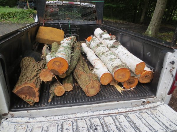

    Scrounged some 7-8" diameter white birch yesterday. Rather than make them into firewood, i decided to make ST out of them. Im thinking of 12" lengths with six slots. Any advice to keep them clean and mold free until they are dried for selling. Ive seen them for sale in front of stores in big box stores etc.

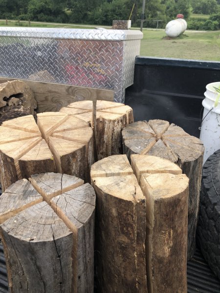

    I have made some as small as 5”- 6” @ 16” long & didn’t have any trouble with them falling over. I use an x-cut on anything under 6” up to 8”. Some of the 8” got notched to 6 pieces over 10” to 8 pieces. It’s an experimental process.
    I gave the pictured bunch to a friend & he said they all burned great even the oblong one at the right.
    I would agree with brenndatomu to get them cut to length soon to start the drying. The ones I made that were not quite dry pinched in at the top while drying so I had to pry them open & put little rocks in them to keep them open. Maybe the birch won’t do this, I don’t know.
