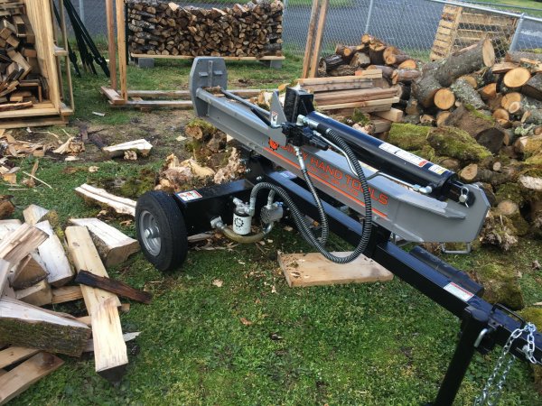

    Yup bought the 22 ton Dirt Hand Tools couple weeks ago and finished my birch with it. Im slowly working with it but a bad cold and allergies has me still in limbo so Im finding it hard to continue working outside for more than an hour. The good weather returns tomorrow, by next tuesday it's be slated to be 85*. :bug::hair::loco: :crazy::picard:
    Anyways I have split some extremely hard maple knots with this. Hopefully still have my pictures.. anything good log size splits like a dream most of the time. Apart from saving your arms, the ground here is super soft. Mostly ground vegetation that is all root. So my hits get absorbed fast into the ground and I'll get a round thats been banged in like 3 inches deep. IMG_1644.JPG

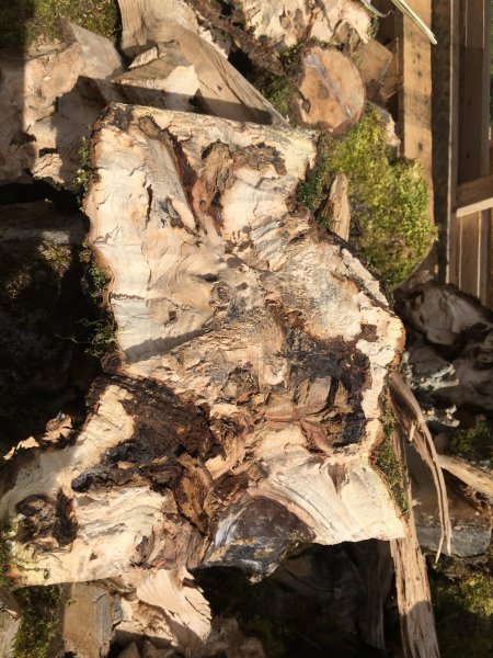

    Here's some of that knotted stuff. It'll slow down for sure but its working. I don't think anyone has a freaking PRAYER getting their maul through this. Not even He-Man. Anyways it is quite quick in terms of cycling, about 11 seconds. Not a hurry but you're getting it done. I find that Im splitting faster than I can move logs away sometimes.
    Make sure you have a cradle for the log half you just split, I should order mine soon.
    Does work for sure good luck!

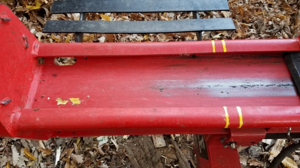

    Marking the beam also helps you see where to stop the wedge when returning it , but mostly it keeps you from splittin up a round that to long to fit your stove ,much easier to recut the round than recut a bunch of splits .

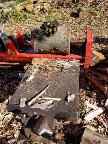

    Mine balances better with the table I built. It is a bit heavier than the ones you buy, plus I mounted a vice so I can sharpen the saw. I will try and get pics when I get some time.

    Oh yeah I like that set up ooh wee! Nice touch with the vice on the end!

    The pipes on the left hold a patio umbrella, one for vertical and the other for horizontal. The vice also serves as a stop so the splits wont roll off.
