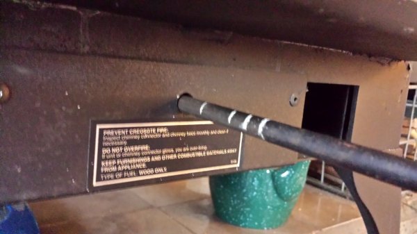

    Lopi Manuals Tell you to place your thermometer over the door , I suggest you move it closer to the center ,In your case probably As far back as you can ,If you don't have one Get an IR thermometer And check for the hottest spot And put your thermometer there Until you get used to the stove ,After that you can move it back toward the front if you want .
    I have my digital thermometer In the center hot spot on my Republic 1750 Then I have a magnet Mount thermometer Closer to the front near the door For reference .
    Like said with warmer temperatures (less draft) and small loads you won't get a whole lot of Secondary burn action , You need to get your stove temp up to about 500 for good secondary burn .
    Like said don't close your air down too fast , close it in increments but, The more wood You put in and the colder the outside temperatures are, The quicker you will need to dial it down .
    When you get your stove choochin good you will find That small movement will make a big difference like one eight to quarter inch On the rod.
    If your air control rod is easy enough to see you might want to mark it like I did , It's easier to tell where your at and you can repeat it .
    First mark toward the stove is my halfway Point ,Last mark away from stove is fully closed , in the pic it is closed One quarter of the way .
