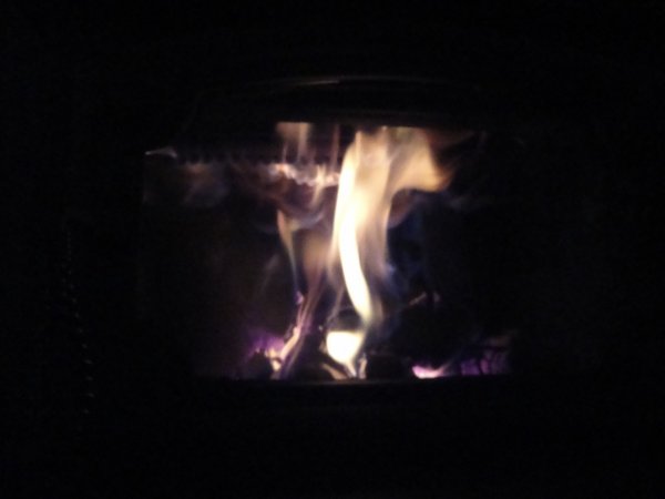

    I got a fire going this morning and after getting the stove up to temp the tubes didn't fire. I am using short wood(12 inch) and I was putting it way in back of the firebox. I just reloaded and put the wood in where it is mostly towards the front and the tubes are firing. It is a beautiful sight. DSC03381.JPG

    Funny how that works. Eh?

    After you start cutting the air back you are not seeing secondary burn?
    How long has the wood been CSS?

    The shoulder season wood I am using was put up 3 years ago and under cover. I believe my problem was the fire was built towards the back of the firebox. With the few fires I have had, I seem to have no problem getting the stove to 700*F with just shoulder season wood. I am wondering what temps I will get using the oak I have available for this winter, especially when filling the firebox. How do you maintain a 500* stove top temp and keep the secondary burn going?

    You can try putting new logs in every hour but that's a PITA .
    You just get used to the ramp up and ramp down cycle of burning.
    Secondaries igniting are just gases burning off.
    I almost never see any secondaries after around the mid-point of a burn cycle.
    I have a north-south loading stove and there's almost never any action on the back tube ( there are three ) .

    Mine is also N/S loading and I think I did see some action on the back tubes when I had the bulk of the wood in the back. I thought I would see more tube action for a longer period of time than I have. Should be interesting when I start putting full loads in during the cold part of winter.

    The secondaries keep firing as long as the have fuel and air. It is possible to kill them by reducing the air too much.
    The secondaries also do not fire during the entire burn. When you are actively out gassing from the wood they run wild. When they are gone the wood reverts to a more normal flame, eventually settling in to a Coaling stage where there is still a lot of heat being produced but not a lot flames. Give the coal bed a rake and some more air and you will be treated to some very hot blue flames from the coal bed.

    Your secondaries will probably burn stronger when your draft gets a boost from colder weather.

    Erik B , I think you'll see the secondaries go much better when it gets colder outside.
    I think I saw it was supposed to get to near freezing up north tomorrow night?
