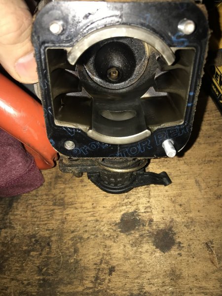

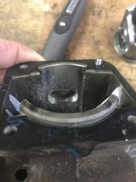

    Just cleaned the casting overflow out of the windows here and then polished
    Intake side. There doesn’t seem to be a whole lot of room with this p/c design so I just bumped the sides out a bit keeping the same shape as the original port. The cylinder side of the intake was originally a bit narrower than the carb side so now it’s straight through. The piston skirt only goes to the edge of the plating here so I left 1/8” either side of the port so as not to lose the seal to the transfers. 036B74BC-EC82-49BD-A9E0-22A8B6AA0A98.jpeg
    The way it looked when I took it off 3D244920-4934-4EB1-83EE-1581269A470B.jpeg A55356A7-EB39-46F8-B370-37AD6D678FED.jpeg
    Wish I had taken some pics of the exhaust port polished out. Got a bit excited and put it back together earlier. Stil need to tune it, but the blizzard going on right now here said otherwise
