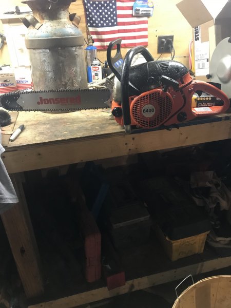

    Its pretty nice just swapped the bar out and it is missing the bushing and the screw for the brake handle but that’s already on its way in the mail :D

    You guys have really been a bad influence on me :D I just quick pulled the muffler to see the piston and cylinder, which are spotless by the way and it took all my willpower to not grab the dremel and tear into the cylinder and muffler:hair: Now I’m on the fence about staying stock or not.... 7CC369CE-CB5B-4900-8E4B-5B6E19721E81.jpeg Sporting the new bar

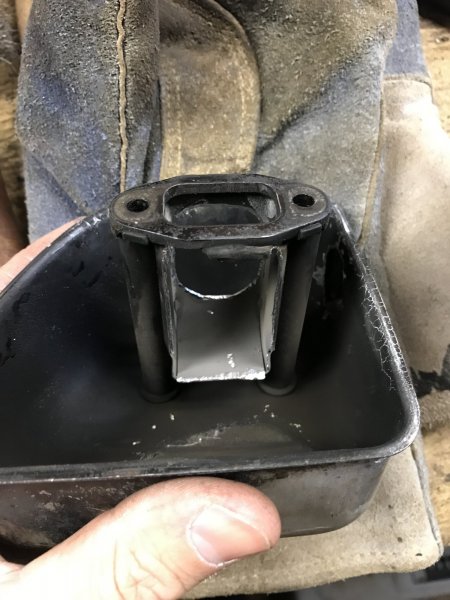

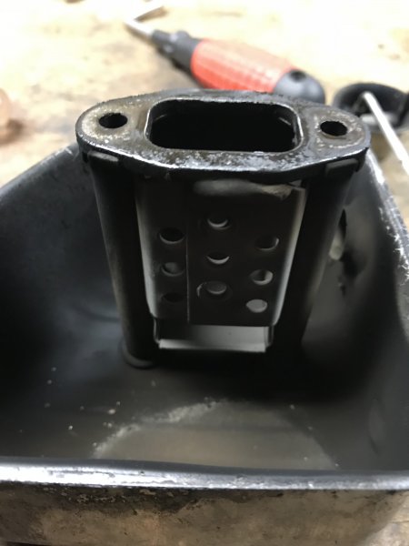

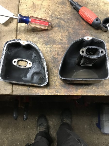

    I couldn’t resist :dremel: followed a little post from Barcroftb and split the can 6DD374D6-B893-4942-9915-27E53777124A.jpeg
    Close up of the cage beforehand
    After some grinding, I decided to leave some of the baffle so the exhaust didn’t blow directly at the muffler can weather or not it was necessary :confused: 4BE9F21F-0C94-46B3-A8C0-2F5BC5C678D5.jpeg

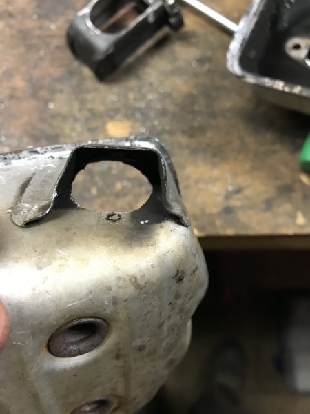

    Opened the outlet port leaving the screw hole for the screen if I ever wanted to put it back on. The stock opening almost seemed like they punched it since there was a bunch of material that was inside the can (look at the second pic upper right) 51F1E443-3C74-488C-A65C-AA0AEC894C4E.jpeg

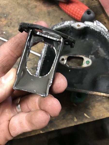

    Baffle back in, I also opened the inlet to match the cylinder exhaust port as well as this plate on the baffle and the gasket so it’s all the same size AB9D6CF6-6C52-4FEC-B939-951B1F0690C7.jpeg cold crimped it back together with some pliers then used a drift and ball pien to tighten it up
