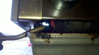

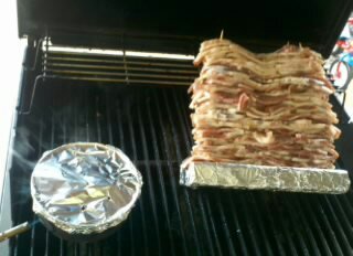

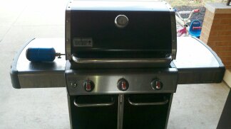

    Here's how I make mine. It is simple and easy and the results are great, but it is not "true" bacon because it technically isn't cured.
    I buy whole hogs from my BIL and have them butchered at a mom and pop processor. I get the bellies sliced to about 3/16".
    I make a brine out of 4 cups water, 1/4 dark brown sugar (light works fine too), 1/4 cup kosher salt. That's the base brine. I usually will buzz up a head of garlic (don't bother removing the paper) and a couple whole jalapenos in a food processor and add that to the brine. Refrigerate the brine overnight. The night before I lay all the pork belly strips (about 4 lbs worth) in vary large bowl in a weave pattern alternating directions to make sure I get plenty of exposed surface area.
    The next morning I"ll wake up and dump the brine into the bowl and refrigerate that for about 4 hours.
    About 1/2 hour before the pork is done brining I'll get the grill set up for cold smoking. Ideally it will be a cool day to help keep the temps down.
    I have a small stainless steel mixing bowl that I drilled some holes one the sides near the bottom...fill it with small chunks of your wood of choice (I usually use apple and hickory bark)...and cover tightly with foil. Poke a few small holes in the top to let the smoke out, but they should be small to keep it from flaming up.
    Layout out all your bacon as tight together as you can on the top rack of the grill. Sometimes I skewer it..sometimes I don't.
    Use a small propane plumbing torch, with the flame as small as you can get it without it going out, and shoot the flame in one of the little holes in the bowl. This will produce a very cold smoke for several hours. I usually rotate the bowl a couple times to keep good smoke flowing.
