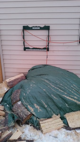

    Long story short I came home yesterday afternoon to a septic system that was backing up. The grinder pump was not pumping.
    The pump is plugged into an outdoor outlet right above the tank pit. The previous owner had installed pipe wrap that featured a stackable plug, think Christmas light plug. Anyway, the heat tape failed and the stackable plug had an open short.
    I was concerned that the system might freeze when the temps drop again. I went into town after work to buy a couple straw bales and could not find a single one for sale.
    I came home, dug out a couple pine rounds that were seasoning, grabbed the 395 and went apechit.
    About a half hour later I had a nice sized pile and an empty saw.
    Hopefully this will get us through.
