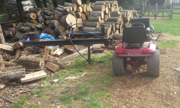

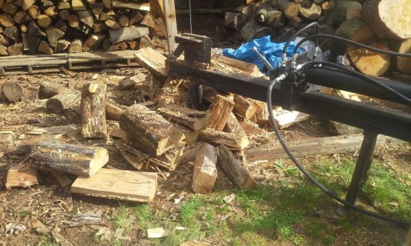

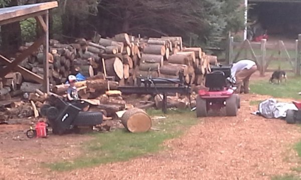

    Its finally done and works great. Just need to scrounge some metal for a table. PHOTO_20140501_161147.jpg PHOTO_20140501_171942.jpg PHOTO_20140501_171951.jpg PHOTO_20140501_171957.jpg Thanks for the help Mastermech and the rest of you guys.
    MasterMech, Oliver1655 and Stinny like this.
