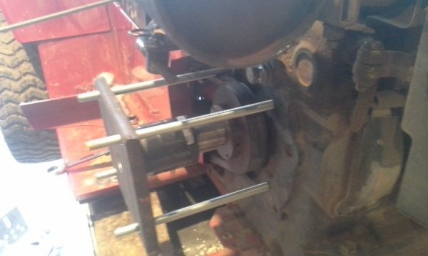

  13. jetjr
    jetjr
    Feb 24, 2014
    3,233
    8,953
    Pa/Md line
    Finally made the mount today err a buddy of mine mostly did it. He has more tools than me. PHOTO_20140412_183312.jpg PHOTO_20140412_195012.jpg

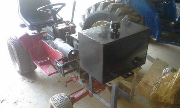

  17. jetjr
    jetjr
    Feb 24, 2014
    3,233
    8,953
    Pa/Md line
    All I have left to do is mount the pump and run the lines. PHOTO_20140421_174921.jpg Got my truck to worry with first though. Its always something.:thumbs:

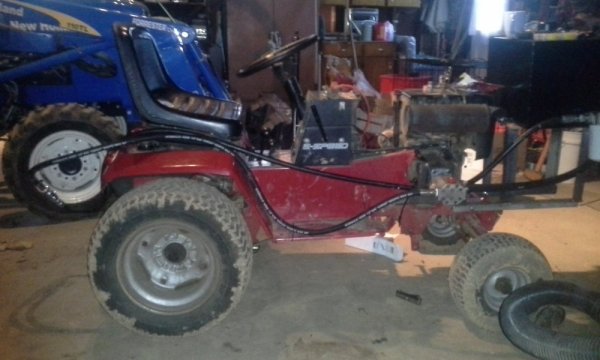

  19. jetjr
    jetjr
    Feb 24, 2014
    3,233
    8,953
    Pa/Md line
    Almost there. its like me not real refined but functional. PHOTO_20140426_072502.jpg
