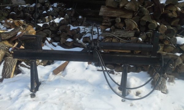

    sorry was not real clear on that part of it. I am planning on leaving the splitter in my splitting area. its built on 4 legs and does not have to be hooked to the 3pt on the tractor. using the wheelhorse as a little mobile hydraulic center type of deal. I guess it would help if i post some pictures. if my phone ever stops being stupid i will post pics of splitter and build as it goes. eventually may convert the splitter to a small trailer type but for now it will stay stationary plus can use the new holland to move wood around as needed.

    PHOTO_20140307_152930.jpg PHOTO_20140307_152940.jpg Here are some pics of old ugly. This is what I am making the" wheel horse hydraulic chariot" for. As i get more into it I will post more pics.
