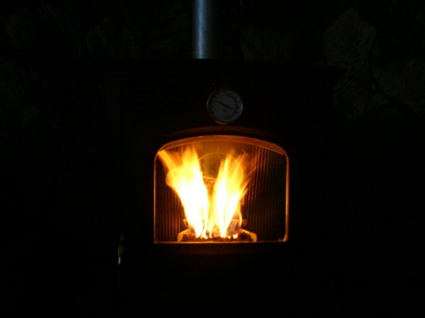

    Checked the air damper and it's functioning as it should. I did a draft test and got -0.5. I've been burning Isabella softwood pellets and have better heat. It has been extremely cold outside that the dino furnace is starting to act up, suspecting fuel is starting to gel as the fuel pump is starting to be noisy at times. I did a full cleaning again as the weather let off a bit and I retried to loosen my exhaust fan from the shaft with heat & PB Blaster. I broke another Allen key in the process. I just wanted to loosen it up & be ready to remove the exhaust motor later. With the furnace acting up, I didn't want to take a chance to do the switch of exhaust motor in case something goes wrong. As I was turning the pellet stove back on, It blew a fuse! I tried again and another fuse popped but this time I seen a spark. It was the distribution fan wiring which moved when I was checking out the exhaust fan wiring route. Something almost went wrong just by been nosy to see what the future job awaiting for me. All is OK now, :whistle: Here's a present pic on the fire and the stove is cranked to the max to fight against these artic vortexes. The inside the door as been free of creosote so the new gaskets have done some good.

  18. DexterDay
    DexterDay Administrator
    12,411
    31,636
    Northeast Oh
    I agree 100%. Have a few :)
    Ivanhoe, I honestly hope things get better my friend. I feel like most things in life are a test, and you need to make it out the best you can, with what you have, and be happy to have made it out of the situation.
    If you need any help with the Fahrenheit (when you do it), you know 343 and I are here to answer your questions. Have you thought about just installing it as a freestanding stove upstairs? They sell a diffuser for the top? If the Harman foes a good job, then it will do a great job. With the bigger distribution blower, it will set up a better convective loop in your home. Just another option...
    gbreda and 343amc like this.
