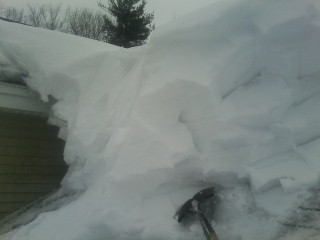

    Today will be part 2 of removing the 4' snowdrift from the roof of my shop at work. Warm weather and rain predicted in the coming week could create problems. We will be climbing up the other side of the roof and attack it from the peak down.

    Is the roof steep? If not, I would shovel from the peak up. Works most efficiently; you just break off "pieces of cake" and then slid them over the edge. Back and forth all the way up.
    On steep roofs, you are restricted to shovel from the peak down. That way, you will stay on the roof and not end up with the snow you're removing!
    I have both style roofs to shovel in my life.

    We have been shoveling roofs for weeks, each roof is different and we attach each of them differently.
    Most of the time it's top down, that way we have a foot hold until the last 4-5 ft. The low man on the totem pole follows us from one side to the other using roof rake and pulling the last 4-5 off from the gutter line. We work on the ice dams last.
