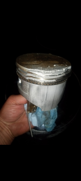

    Saw a free Honda GX240 on FBMP the other day...said it was seized up.
    I decided to go grab it, gotta be good for parts at least, or maybe even easily repairable.
    I talked with the guy while picking it up, he is a mobile mechanic for an outdoor power equipment place, so I thought, yup, this one is likely actually junk.
    After talking with him about it a bit, he n his kid (18-20 yo maybe?) put new rings in this thing to fix an oil burning issue (unusual)
    Then it started making bad noises and smoking worse than ever...they shut it down and put a Predator 8 HP on it.
    I popped the case open to check the rod n crank and found the rod bolts loose, very loose! Things didn't look too bad so I put it back together to try it out... would not turn over 360* without locking up, but not seized locking up, more like clunk, sudden stop!
    Pulled the plug out and checked the combustion chamber out with a bore scope...broken piston.
    Pulled the head and found the ring lands blown clean off the front of the piston (rings too)
    Pulled the head to check the cylinder, it still looks good, so I'm going to rebuild...I found a nice oem piston/rings/rod assembly on eBay for $20, so I'm gonna try to save this thing.
    I'll be under $40 all in with gaskets, so if it doesn't work out, I still have lots of good parts for $40, and a couple hours of fooling around.
    I think it's gonna work fine though.
    Oh, and I believe he let the kid rebuild it and he forgot to set the torque on the rod bolts...piston hit the head, or valves, which broke it...lots of ring bits laying on the piston, and some in the muffler too. Surprisingly the valves and pushrods seem fine, although the valve adjustment was way loose, which he did mention setting. Jr still has some learning to do...

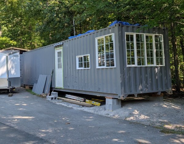

    For the past month or so I been doing a tiny house build outta a 40ft shipping container. Would love to share some pictures but ..... Maybe someday this forum 'll get fixed.

  13. Jeffrey Svoboda
    Jeffrey Svoboda
    2,884
    16,984
    Some of them do, sometimes. I could crop this one and it uploaded. Not really trying to edit pictures to get them to upload. Don't need duplicates and I want the original size saved on the phone, readily viewable. No book face here. Might do a YouTube video, might not. Lol

  14. buZZsaw BRAD
    35,036
    216,914
    Id live there...but only if it had wood heat! :coldfire:

  20. Jeffrey Svoboda
    Jeffrey Svoboda
    2,884
    16,984
    Yeah I'm gonna live in it for a year or so after it's built and hopefully find some property to move it onto. Then maybe a little longer. IDK how I'm gonna move it, that's a problem for another day. Lol. Seriously though they're not too hard to move. Can be done with the right trailer and pickup truck. Most shed movers have the capacity. There's lots of container sellers that'll move um I assume. Can be put behind a semi truck and taken across the country.
