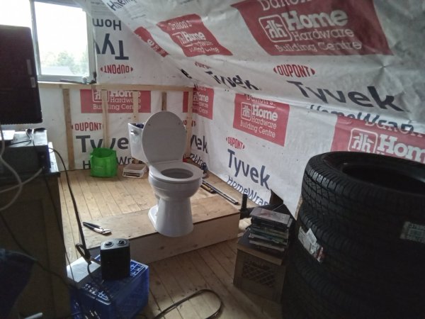

    How does one sit to poop in and elevated toilet?

    Need to build more floor around it. Wanted to make sure the setup and layout would work as planned before going all in.

    I see, so it will now be a 2 bed 2 bath home? Cool!

    Pretty much, yup. My room will have a very conveniently located bathroom.

    I was gonna say, I'm pretty tall and that still looks like a bit much! :rofl: :lol:

    Nothing is out of reach if you dream hard enough :banana:
