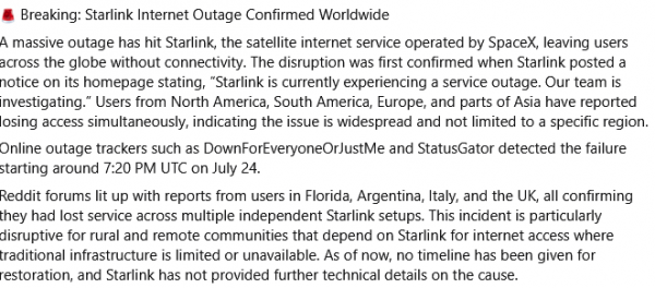

    My Starlink was down for 2.5 hours today, weird! And glad yours is back up.
