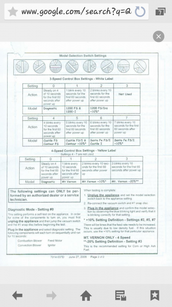

    Where is the auger cover set? If it's set pretty low you won't get enough pellets in the pot to trip the thermocouple (small fire = little heat) and start the feeding process.
    The thermocouple not touching the ceramic cover would do the same thing.

    The feed gate is set to about 80% open , I would like to run it all the way as I like a big fire . :D

    When running Low or Med? I always left it open 100%. You'll never over fire that stove on Medium. I also turned mine up 10% on the control board.
    CleanFire, ttdberg, Russell and 3 others like this.

    Dex...did that make a big difference?

    Because I ran on low most of the time (low and slow 24/7) it did help a lot. Because there was days I needed Med for a shirt period. The extra 10% on Low helped me a lot.
    It will be #2 on your control board for 10% increase. Be sure to unplug the stove before doing any work.
