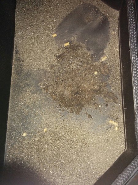

    Checking all that now. A couple of pellets in the burn pot and this is the ash draw.Thermocouple wire was 1/2 inch out of the cover.

    Hmmm....I'm thinking the stove isn't seeing the proof of fire after the initial drop of pellets into the pot.
    ttdberg, Russell and will711 like this.

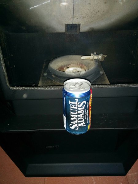

    Ok everything cleaned , tighten and Thermocouple wire pushed back in . I'm pretty confident that should do it . It's Sam Adams time.
