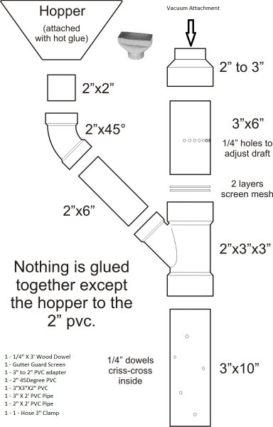

    A pellet vac set up. Some of the gang made their own DIY and it works nice. Less dust in the house too!!
    Paging imacman DexterDay
    ^These guys made their own and might share the how to info!! ;)

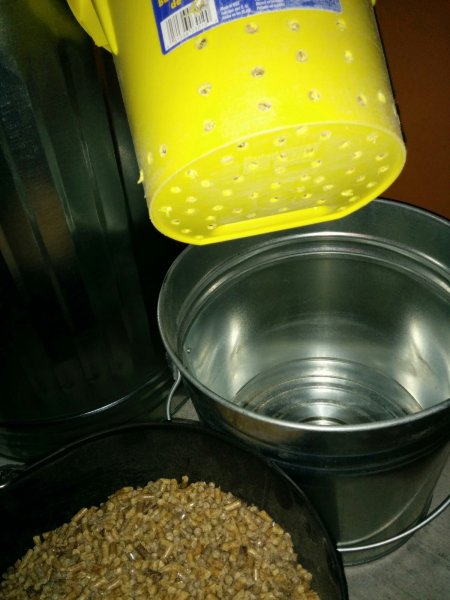

    Quick fix . Plastic paint can drill holes reach into large trash container with pellets , shake fines into small can pour into coal hod .

    Very impressive gadgets , maybe when I have more time would be cool to build something .

    I made mine based off of imacmans plans, but built a housing for it.
    With a bottom feeder ( with dual screw and cylinder type augers) it is no longer needed. So it went in the trash.
    I had it up in the For sale section here (for free) over a year ago. No takers that were close enough to get it though
