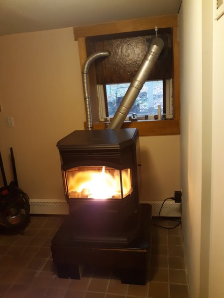

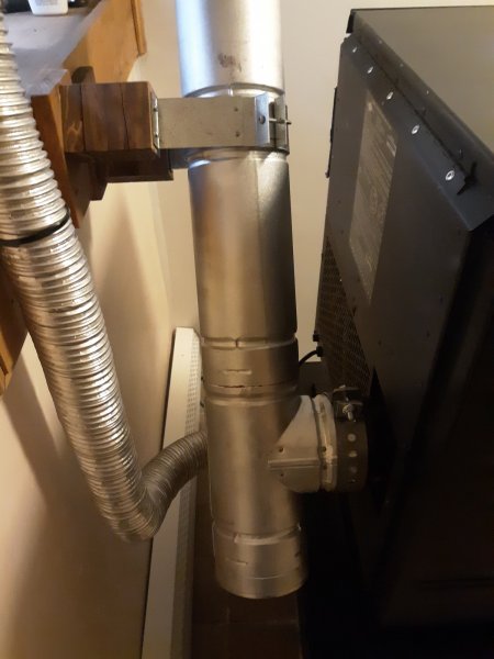

    We have a Enviro Mini, a PP130 which was removed from the basement and replaced with a Lopi Yankee PS that I just rebuilt, and yesterday finished the install. The PP130 is going to replace the oil blaster in the garage.
    The PP130 has a OA pipe directly to the burnpot chamber from the outside air connection, which I ran it with very sucessfully.
    The Enviro Mini, is nothing more than a short length of pipe that dumps out directly behind the back panel and is not connected to the burnpot chamber at all, so I didn't bother with the OA.
    The Lopi has a pipe leading to the burnpot chamber, but there is a large rectangle hole in the side of it. Soooo.... I attached a piece of sheet metal over the hole with high temp rtv so it gets nothing but outside air, and yes I have a functioning CO detector.
    What would the point be to connect OA to a stove that is not connected to the burnpot chamber? The way I see it, all it would accomplish would be putting a 2in hole in the wall.
    I lit it yesterday for the first time in the house, after sealing and securing the chimney sections, and it has run for almost 24hr now as low as it will go, and it has kept the whole place a nice even temp.
    The pellets we have are completely new to me, so the jury is still out on them.
    The glass is a little dirty, but nothing you would not expect running a big stove low and slow for a long time. The burnpot is pretty clean and free of clinkers, unlike the PP130 which would be clogged and the glass totally black.
    So anyway, looks pretty good so far and seems to be a worthwhile expenditure to upgrade from the PP130.

    The OA was put in in place for the other stove, and I did it because it was our first stove. I just went with it as that was what the "experienced" overlords said to do. I put a plate over the side opening on this stove to keep freezing cold from constantly coming in. I think I should just take the whole OA thing out and cap the hole.
