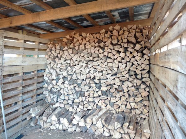

    It depends on how much room you want to take up and materials you have on hand. If you can keep the pallets off the ground they will last a long time. If your wood is dry, stack it tight.
    The first shed is 7 1/2 ft wide, 14ft deep and about 6 1/2 high on low side. It holds 5 cords, 9 rows of 18" wood, with scrap OSB on top of pallet floor, next two raxks are built from 50 x 50 pallets, so they hold 1 full cord per side. Fairly cheap to build.
