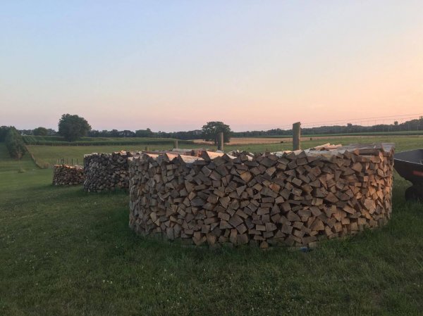

    I'm still neck deep in the project to install my wood stove, and am not going to have the time to get to build a wood shed like I had originally planned...my wood hoard consists of 4 partial Holz Hausen, two of which will be used for this season. I am considering just building a quick 4x4 frame around the two I'm using, with a metal roof and slats for the sides, and figure I'll bring .5 cord into the garage for my ready pile...any other suggestions?

    Any kind of flexible material will sag to the middle of your round stacks, as indicated in your picture. At least, it looks like it would sag. You'd want to raise the middle of your stacks to more of a dome and less of a bowl. If no roofing rubber is availsble, then tarps would work for a season or two. First few dome pallets to toss on top to hold it down. But you need to get those stacks to shed water first.

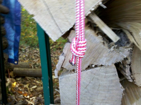

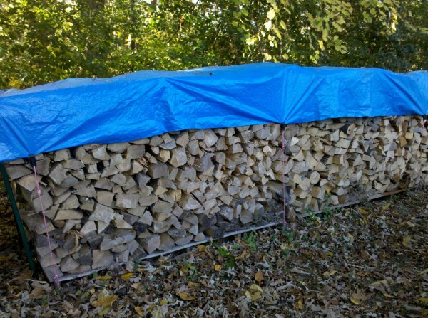

    You could throw a pallet or a sheet of OSB on to keep from sagging in the middle and just tarp them.
    Put some 8d nails in bottom splits to attach rope or bungees to the tarps , I us rope with nails in the pallets , I tie an adjustable hitch knot that you can slide and tighten or loosen up.

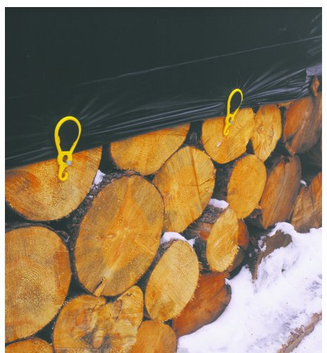

    I use these Tarp Tie-Downs now, they work the best ,they will not come off. Don't get the black clips in the pic they don't hold as good

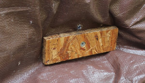

    I use the ever popular scraps of chip board, dipped in Thompsons Water seal and screws.
    I know these won't come loose.:cool:
