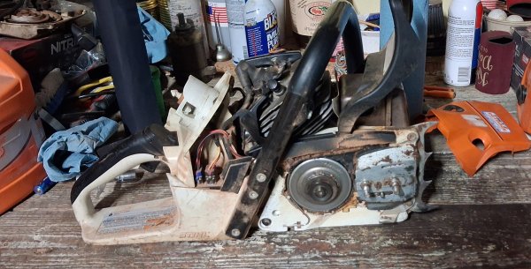

    Replacing the handle on the neighbor’s Stihl MS180. Made the mistake of removing the handle grommets from the motor side and got a hard lesson on how miserably difficult it is replace them. Really sours me on Stihl saws if they are infested with poor designs such as this.
    Bottom line is if the grommets need to be replaced, the real labor cost is more than the saw is worth.

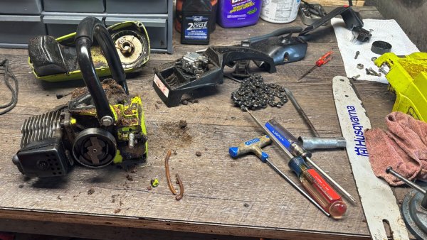

    I'm finally messing around with this top handle Poulan I picked up for cheap back in the springtime. I originally thought this was a XXV model, but the more I look it over, I think it's a 2000 (I know next to nothing about these saws so correct me if you know better) It needs the usual: a fuel line, a carburetor cleaning, and also the air filter element crumbled into oily grit when I gained access to it. Luckily my local hardware store which is also a Husqvarna dealer had some 5/64" I.D. generic rubber fuel line in stock. I bought an 18" section for less than $3. Getting it apart was fun... flat head screws galore. I like to think that Pol Pot, Mussolini, the Austrian painter and the guy who invented flathead screws are all burning in hell together right now. Anyway, I'll be replacing the flatheads with either button head or regular socket head cap (Allen) screws. I watched a few YouTube videos of these saws running so I'm more than a little excited to see this old thing hum once again.

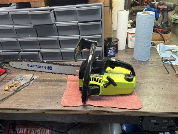

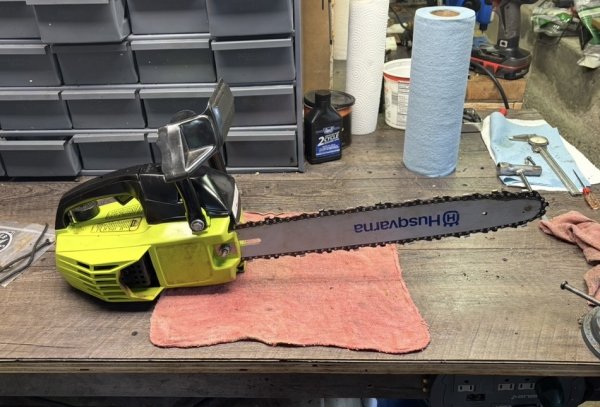

    Cleaned up decently and all back together. New fuel line and filter, a new air filter and a few missing screws that I had to rummage through my stash for. The carb diaphragm was a little iffy but I decided to try it anyway. It runs but bogs when under full throttle. I’ll order a carburetor kit and that should do the trick. Call me crazy but I think I might actually like this stupid little saw :)
    buZZsaw BRAD likes this.
  5. buZZsaw BRAD
    35,202
    217,956
    Needs a Poulan bar.
    Im pretty sure my late uncle had the same or similar saw. Somewhere there exists a pic of him cutting up a limb in my dads yard from Hurricene Gloria September 1985.
    Kinda makes me wanna try a different saw brand! ;)
    Eric Wanderweg likes this.

    In years past I cut a lot of wood with a small Poulan just like that. Great little saw for what it is, but I'm glad I ended up getting bigger saws.

    Thanks for your input. I have plenty of larger saws myself but I'm still hoping to get some cheap thrills out of this little saw when the job calls for it.

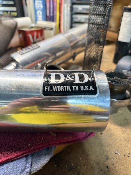

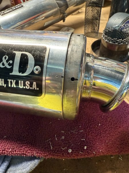

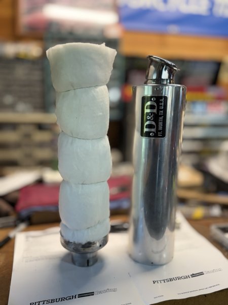

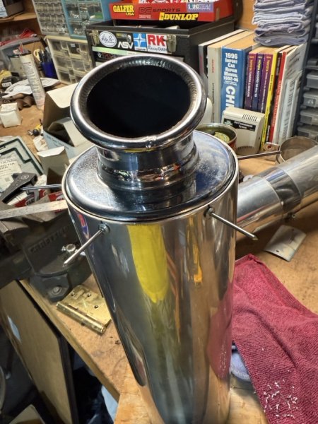

    Finally getting around to rebuilding one of the cans on an older dual slip-on exhaust system for the Superhawk. Hope to resell it.
    Have to drill fresh holes for rivets.

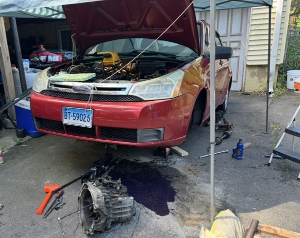

    Not exactly on the bench but I sure made a mess on the ground… The slave cylinder for the clutch went bad. While the transmission is out I’m replacing the clutch and rear main seal for the engine. Also I ended up buying new lower control arms since the ball joints were shot. New front shocks too since it rode like garbage. The transmission shop quoted me $2300 for the job which I wasn’t going to cough up for a car I bought for $2k. So, I’ll struggle through it and save a few bucks. Luckily I have my truck to use in the meantime.

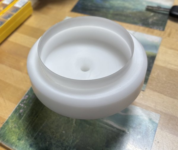

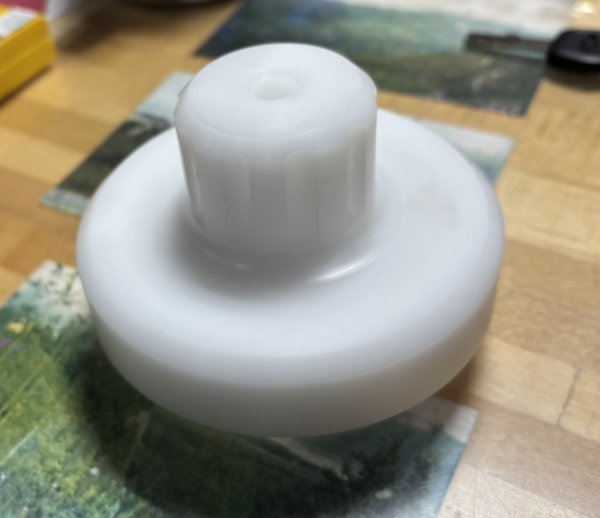

    Project Ford Focus ran into a couple hiccups. The rear main seal didn’t come with an installation tool so ended up making one from white delrin. That saved some time and a little bit of money.

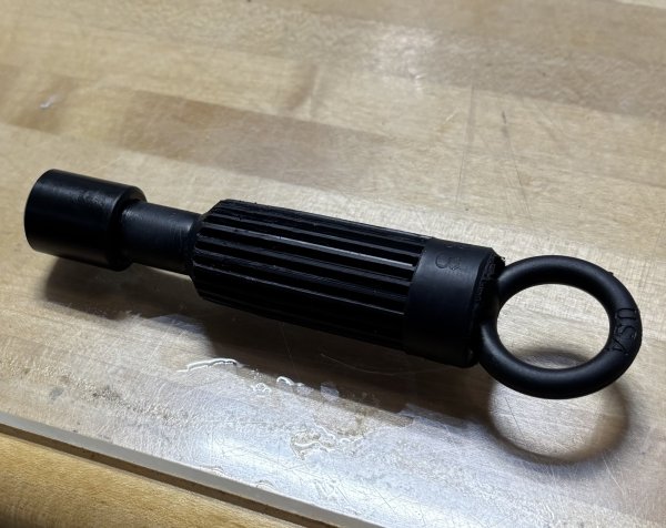

    The next problem was the alignment tool they sent me with the new clutch kit. The spline fit the disc, but the pilot diameter was too small at the end. At first I wondered if I lost the pilot bearing/bushing in the end of the crankshaft, but after scouring the internet I found that the car doesn’t have one. The shaft on the transmission is not supported by one, oddly enough. So then I rummaged through my stash of sockets, bushings, extensions and various clutter trying to find something to cobble together to line up the disc on the flywheel, came painfully close but no luck. Then I decided to turn up a sleeve and then glued it onto the existing alignment tool.

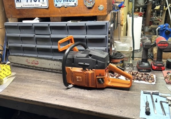

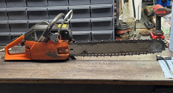

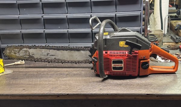

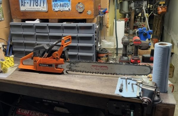

    Project Husqvarna 61 with a Jonsered 670 top end on it is (hopefully) buttoned up now. I had started it last weekend but discovered that it had an air leak. It wouldn’t hold a tune. I had torn the rubber intake boot slightly but decided to try it anyway. No good. A proline brand from saw salvage came to the rescue. When trying to change it out, I saw that I had no access to the steel clamp screw for the rubber boot either. I had put the boot on when the cylinder was still off, which backed me into a corner. So I pulled the entire top end back off, changed the boot, flipped the boot clamp 180 degrees, motosealed the base of the cylinder and reassembled. While it was on the bench I also put my new used Jonsered starter cover on it, which came in today. I figured why not make an ugly saw even uglier by adding another color into the mix :) The only thing left to do is change the spring for the chain brake. I have a good one in a bad clutch cover, so I’ll swap that over eventually. For now I just want to try this thing out. It’s been a long, drawn out saw build…
