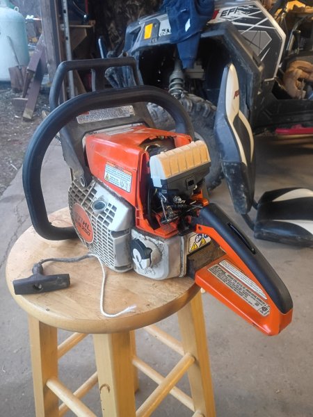

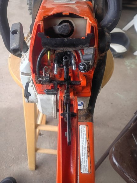

    I don't work on saws much anymore my job is 12 hour's a day 6 days a week but is slowing to 5 day's
    I didn't have my tools at my nieces but got the carb swapped out and a new fuel line and filter IMG_20260108_171822487_HDR.jpg
    Of course as soon as it started the pull rope snapped and I didn't have any with me IMG_20260108_173506533.jpg
    I gave this 10/10s back to the kid who found it in the trash

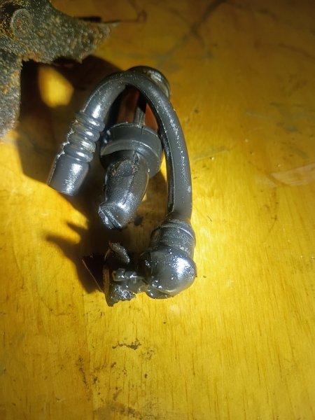

    I put a nos fuel line and new bar and chain on it IMG_20260108_173251020.jpg IMG_20260108_172517815_HDR.jpg
    That fuel line completely collapsed and dissolved.

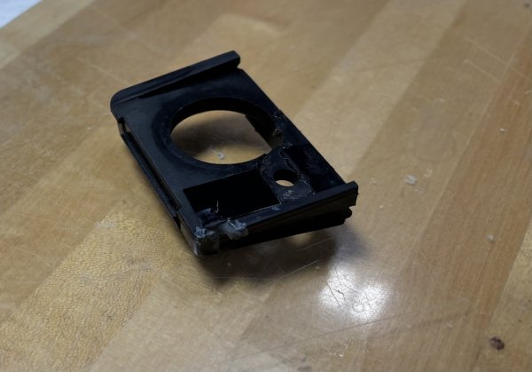

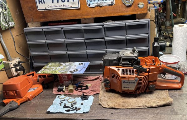

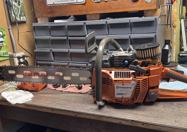

    5 months later and I’m finally back on project 395XP. I got the top end back on, as well as a bunch of odds and ends, making good progress until I hit a snag. The plastic intake shield was broken when I took it apart back in November. I’ll have to find one before continuing on.
    Deererainman, Ron T, John D and 5 others like this.
  4. Eric Wanderweg
    8,626
    68,459

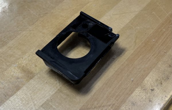

    It turns out that the part I need isn’t so easy to find. I have a part number and found a couple places that sell them, but in the meantime I’m trying this Mickey Mouse repair. I was able to use some industrial strength adhesive and patch this one back together. I also added a couple patches of thin plastic shim to shore it up a bit. Lastly I put a dab of epoxy in one of the corners where there was a void. It doesn’t have to be perfect, it just has to work until I get a replacement. This is what desperation looks like :whistle:

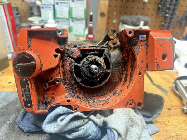

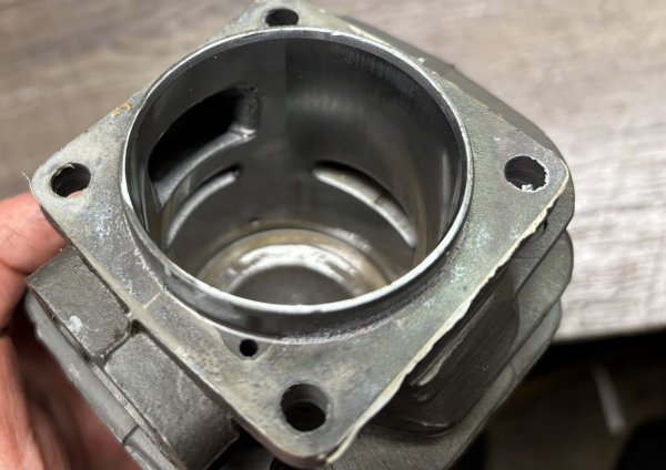

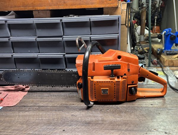

    Perfect timing for this topic. I wasn’t going to take pictures tonight of this ongoing project but it’s a good example. I built this 61/272 a year ago. At the time, I couldn’t find an OEM cylinder so I bought what I thought was a Meteor. It was a China cylinder and in the online picture, it had “made in Italy” embossed on it. Upon receiving it, I saw that I got screwed. I decided to run it anyway. Performance wise it seemed fine. The saw pulled like a 70cc should. I put maybe 4 tanks of fuel through the saw, using Echo oil at 40:1. I did end up getting an OEM cylinder last August but sat on it for about 7 months until tonight. After getting the imposter cylinder off, I was mortified by how worn it was after 4 tanks. It’s not worn like a bunch of fines got sucked in. It looks to me like the plating is soft and the hard Caber ring I was running wore the honing marks off of both the intake and exhaust walls. I haven’t run the saw since the end of last year but I’m glad I finally tore it down and put the right cylinder on it. It’ll be interesting to see how it performs.
    Sorry about the crap pictures but you get the idea.
    It’s funny, I went down to my work area tonight just to make some 62 drive link chains for this saw (I’m running an 8 tooth rim sprocket with a 16” bar, so I needed to add a couple drive links) I knocked that out quickly so then I decided to go all in on the cylinder swap. Luckily I still had a brand new 52mm Caber ring kicking around to start fresh with.

  19. Czed
    Czed
    Jan 26, 2016
    3,748
    24,022
    Wv
    I bought many white box ebay china cylinder kits that were stamped meteor
    Legend had it and I don't know if it's true they came from the same forgings as meteor but are plated completely different
    I know porters they hate meteor because they are so tough to grind on.
    I probably have at least 6 266,268,272 saws in parts I can make complete just no time
    Working 12 hours a day 6 days a week
    Maybe when I retire at 59 and a half
  20. Eric Wanderweg
    8,626
    68,459

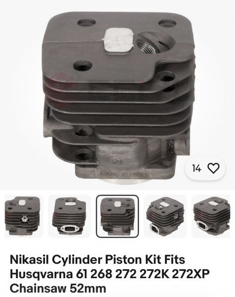

    Here’s a screenshot of what the advertisement looked like when I ordered it. When I got it, I saw that the made in Italy part was ground off (they probably got busted for false advertising)
    At my work, one of the engineering departments has some 3D scanning tool that can generate a 3D model of just about anything. I’ll bet the Chinese have the same exact technology so they scanned a real Meteor cylinder, which obviously put the Italy embossing into their counterfeit model. If not for the plating issue, I wouldn’t hesitate to run this cylinder again on a beater saw if I absolutely had to. Like I said, performance wise it seemed fine. The ports looked decent, symmetrical, nothing crooked or skewed.
