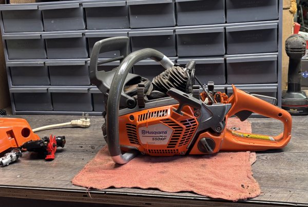

    Next up in the free saw salvage series is the 550XP. Right off the rip it’s going to need a carb kit. The diaphragm was pretty stiff (probably the reason it wasn’t pulling fuel)

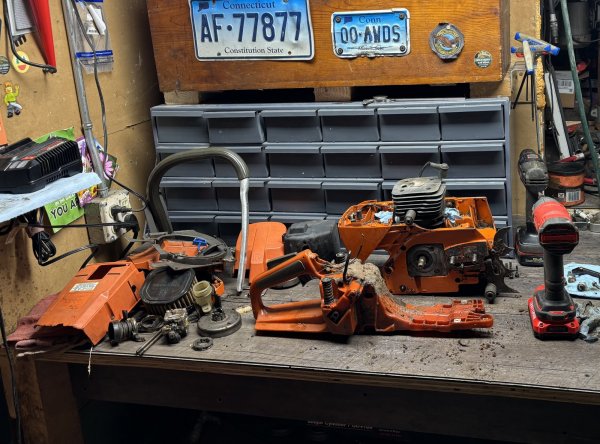

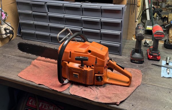

    Newly acquired 395XP. Just going through it, cleaning, and doing the usual stuff that we do when we get a used saw. The original machining marks are still on both the intake and exhaust side of the piston, so I think this’ll need minimal work before I put it to work. So far the only thing I found that I need to buy is a fuel line.

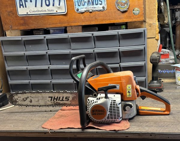

    Nonsense! I just got that MS250 running the other week… I’m balanced :whistle:

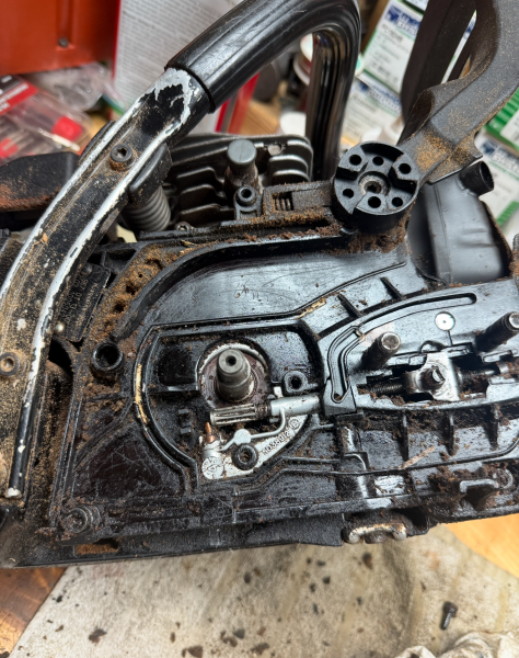

  8. Eric Wanderweg
    8,713
    69,244

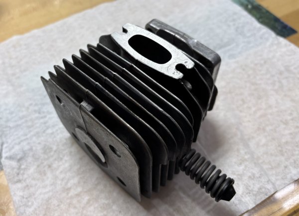

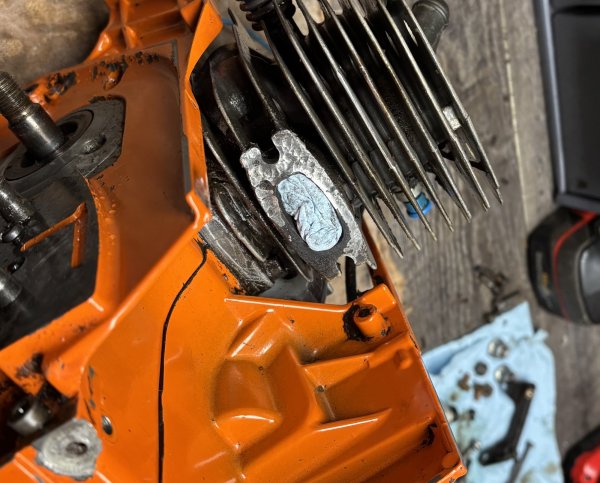

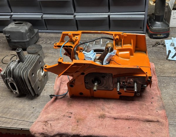

    Other than all the missing screws, here’s the first WTF thing I found. The muffler was rattling loose for so long that it boogered up the mating surface on the cylinder! I’ll have to file that flat again. Maybe I should just pull the cylinder at this point.
    Yeah… it’s at that level now.
    This is exactly why I tore it down first before making a single cut with it. When you see missing hardware and loose parts, that’s a huge red flag. It might’ve been running, but it wasn’t ready to run.

    Even if the exhaust flange wasn’t damaged, I’d pull the cylinder and re-ring it at a minimum. I scored a 394XP a few weeks back in a tad better shape than your haul. Ordered new rings, base gasket, carb kit, muffler, and clutch bearing. It needs AV’s as well, but still on the fence if I want to shine it all the way up or not.
  10. Eric Wanderweg
    8,713
    69,244
    That’s where I’m at with things now. I’ll be going down the same road.

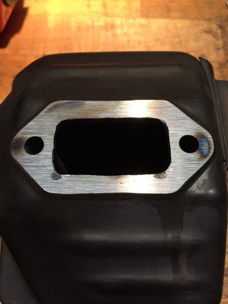

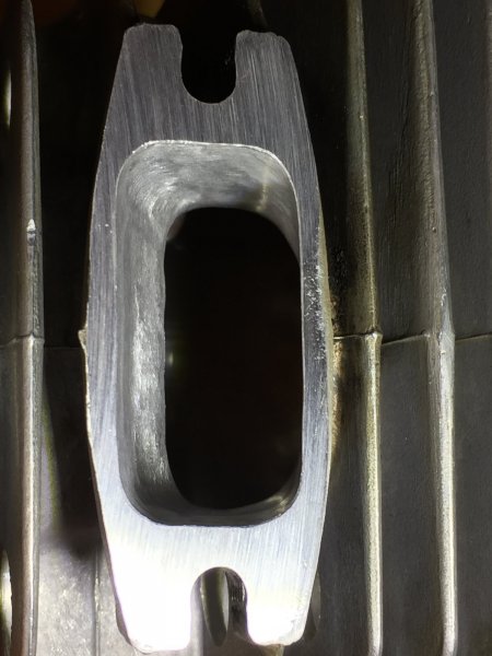

    I got the exhaust flange milled flat again. I ended up taking about 0.030” off, and left a small amount of pitting where it didn’t matter. At least now I’m confident that a muffler will seal against that surface. I couldn’t get a good picture of the inside of the cylinder but it looks great in there. Other than the cleaning of all the parts I took off, this 395XP project will be on hold until after the first of the year. More to come though…

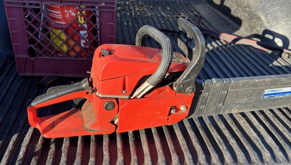

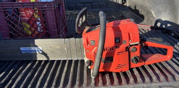

    Another side quest :whistle: My coworker picked this up at the town dump where he lives. He had plans to tinker with it but decided not to and gave it to me. If nothing else I gained another bar and chain, and best of all another scabbard. It’s dirty but the hours look low on it and all it needs right off the bat is to fix the pull cord. I hope that’s all it is because I’m not putting any money into it.

  16. Eric Wanderweg
    8,713
    69,244
    No doubt this would make for great GTG entertainment at night! I can’t see this saw being worth much else.
    Like I said, I’m happy to get another scabbard, especially a black one that’s a good match to my 372xp.

    I have a 395 cylinder that I bought for cheap that had that same damage to the exhaust flange. I still need to build it up with weld so I can machine it flat again.

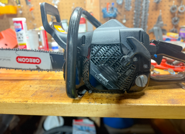

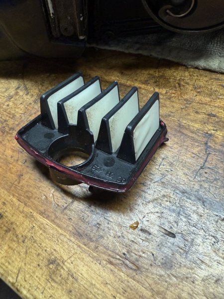

  20. The Wood Wolverine
    18,986
    122,589

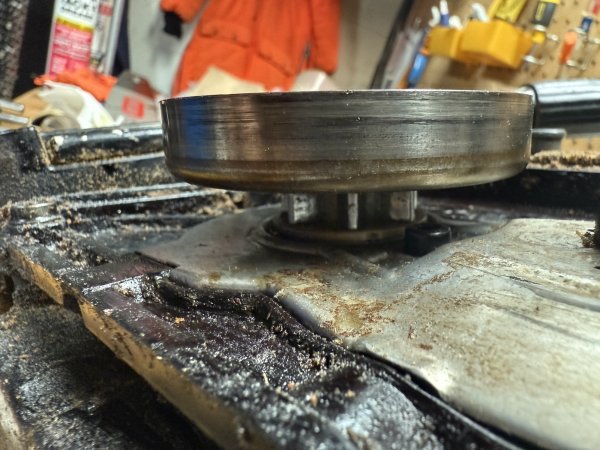

    Decided to put the spur drum on the 2150 and get it back in service. Massaged the inner bar plate to try and keep the leaking at bay.
    Probably should order a new one.
    Also cleaned the filter. I need to get a flocked one. Hoping a little grease will help keep it from letting fines through.
    Should be good to go.
