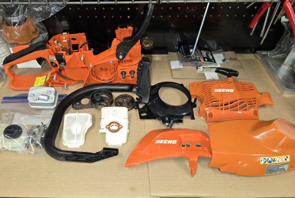

    A clamshell saw that's designed with common sense. 15-20 minutes and its completely apart. Same with the Echo CS400. 20250829_133437.jpg

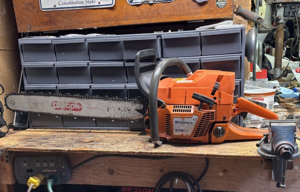

    Not on the workbench yet but coming soon. I was very generously gifted these saws yesterday by FHC’s own jo191145 . They had a few years of grime on them from sitting around, but a quick blast with super clean and water made a world of difference. Thanks again Joe.

    I should've taken pictures earlier this morning but I was in a rush. I pulled the muffler on that 372 and the piston looked almost new on the exhaust side, and it was the type with 2 rings, most likely original OEM. Then I pulled the carb because I had to clean that anyway, and had a look at the intake side. Most of the machining marks were still there as well. This thing's going to be a runner pretty much as-is. Strong compression and plenty of spark. Just going to do a little more cleaning, make sure the carb is good inside, take care of the case bolt/bar oil seepage issue and fire it up. I almost feel like I hit the lottery LOL

    One thing I noticed about that carb was that the limiter caps were gone from the adjuster screws. Whoever owned it before you must've removed them and adjusted the high screw too far out of whack. Out too far in this case is better than in too far though.
    Super clean is awesome stuff. I mix it with water in a bucket and soak certain parts overnight sometimes (it'll turn the color of cylinders darker if you leave them in too long) If you're just doing a quick cleaning on a complete saw it cuts right through the oily sawdust and caked on grime. Still gotta scrub a bit with a rag/old toothbrush/old sponge on the really bad areas, but it takes a lot of the labor out of the job.

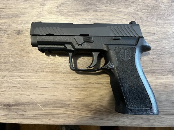

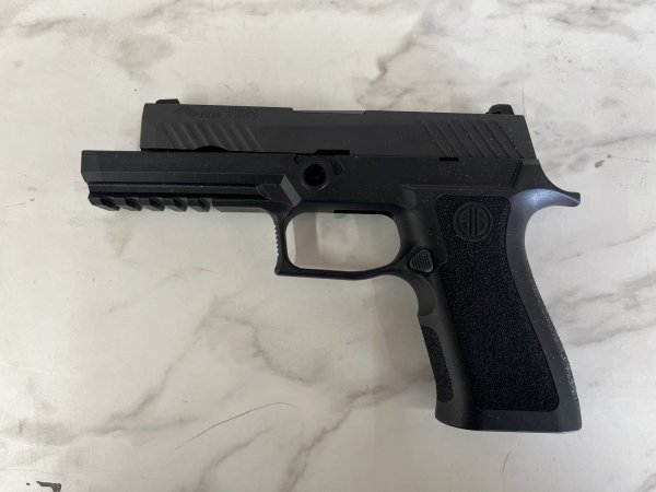

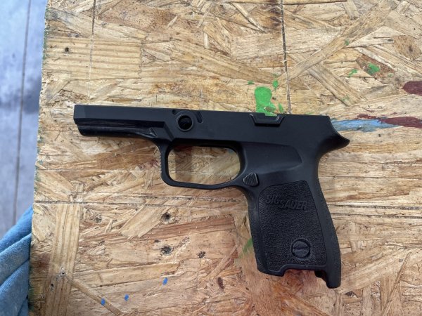

    So I was playing with this idea, I wanted to do a few mods just to see if it could. be done. The first one I removed the rail, radiuses the trigger guard, and added a fake screw.
    The second one I wanted a flared magwell but did not want to add length or girth to the grip, overall gun. So I made a form, heated the frame and pressed it in. I also trimmed the beavertail and trigger guard. I am thinking about molding in a light without increasing the size, might be a challenge I have found a light already.
    This is the original frame
    this was my flaring form
    this is reassembled
    The Wood Wolverine and John D like this.

    Got the free 372XP fired up and tuned this morning. I didn’t spend too much time cleaning it up yet but I’ll get to it eventually. Cleaned the carburetor, took the clutch drum off and got that and the bearing cleaned/greased. I had a brand new Archer 8 tooth sprocket on hand so I put that on. Dumped the old fuel, got fresh mix and bar oil in it. It was missing a case bolt in the front so I replaced that. Ran it for a few minutes and ended up turning down the oiler a bit. Seems to run flawless though :thumbs:
