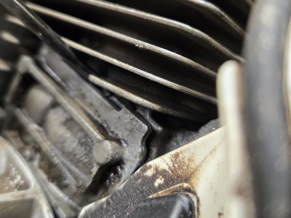

  11. Lehman
    Lehman
    Dec 21, 2021
    616
    2,047
    Minnesota
    Lost a transfer cover didn’t it. New style ones don’t have them just like husky tried the epoxy on covers and it failed for both companies .
    metalcuttr, John D and ammoaddict like this.

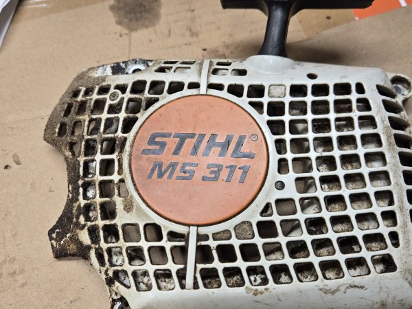

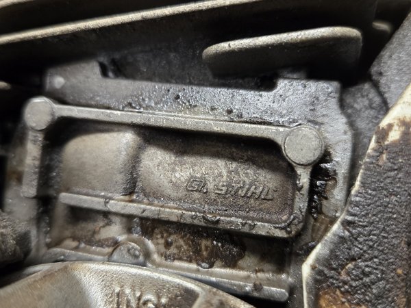

  12. Lehman
    Lehman
    Dec 21, 2021
    616
    2,047
    Minnesota
    The old ones are kind of a lost cause just like the 271/291 no idea why it posted 3 photos
    metalcuttr and John D like this.

    So my nephew says the guy wants a quote on a new parts plus labor. It also has a cracked muffler because it was left loose to rattle around for God knows how long. Cracked around one of the bolt holes. I told him he'd be far better off with an Echo CS590 Timber Wolf or a CS620P. He can probably buy the 590 for what repairs will cost. To be honest, I hate working on these and really don't want to tear another one down if I can help it.

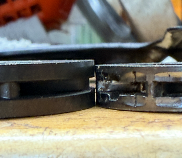

  14. MAF143
    MAF143
    Dec 8, 2018
    1,732
    12,232
    North Central OH
    reed induction air leak... novel concept...
    :dremel: :makeitrain" I hate working on some saws too, but lots of folks around here can't afford much for a chainsaw and I try to fix their saws for as low a price as I can and justify it as trying to pay it forward...
  15. Lehman
    Lehman
    Dec 21, 2021
    616
    2,047
    Minnesota
    Clamshells aren’t that bad in general

    I was surprised the owner didn't tell him about the nasty metallic clanking when pulling it over. He just told my nephew it won't start and the muffler is loose. I thought the bottom rod bearing fell out lol.

  19. Lehman
    Lehman
    Dec 21, 2021
    616
    2,047
    Minnesota
    Definitely not worth the effort to fix and I won’t mess with one even unless it’s the new style with no covers. Was a poor design to try the glue on covers by Stihl and husky both with same results.
