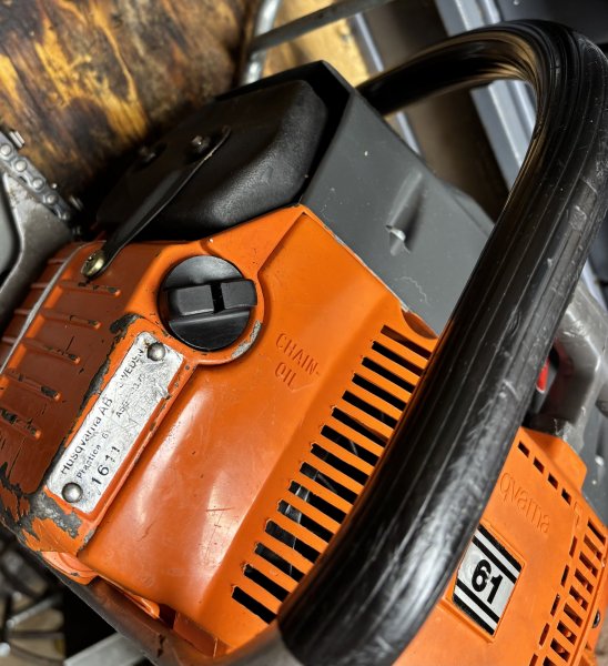

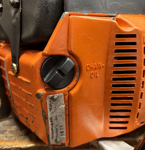

    It’s been about 6 weeks of on again off again scouring the internet for an oil cap for this vintage late 70s 61 case. I found the Husqvarna part number and determined that the cap also fit a 162. Armed with that information I kept looking, to no avail. Nobody is making these caps anymore, OEM or aftermarket. Such is the case when you’re dealing with 40+ year old saws. I did find a place in the UK that had a few in stock but they didn’t ship outside of the UK. It was then that I decided to just make one and add an o-ring for the seal. After some measuring I figured out it was an M24 X 3 thread, and the cap had to be vented because the oil tank lacked a vent. For this I just drilled a 1/32” hole through the center. It might weep a tiny bit of bar oil when laying sideways but I can live with that. Maybe some gauze attached to the inside of the cap will help? We’ll see. At least now I can tune it in the wood and actually use it.

    I tried fitting an oil cap from a 1984 saw on this late 70s case. If you turn down the diameter of the cap to about 1.06” it’ll fit but the thread is still a couple MM too big. If you need a couple of the really old caps like I just made let know. Now that the design is done I can make more.

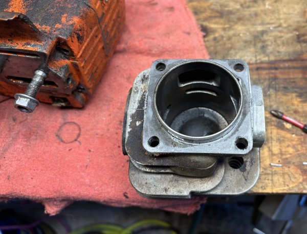

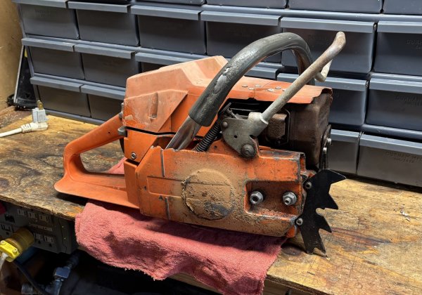

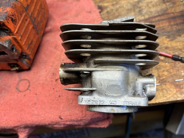

    I picked up this 268 (non XP) parts saw for $75 off eBay last week. It’s obviously in rough shape and needs quite a bit of help. It’s got spark which is a huge plus. The clutch cover had some weird brazing repair work done to it so I’ll consider that garbage. Upon pulling off the cylinder, I see that it’s not an open port like what should’ve been on there. I measured the bore and it’s actually 52mm which means it probably came off a 272XP. Unfortunately this Mahle cylinder is missing half of the top cooling fin, but the bore itself looks good. What to do…

  7. brenndatomu
    25,312
    164,790
    Run it!
    What's it gonna do, damage the cylinder ?! :rofl: :lol:

    24,032
    Wv
    Fins mean nothing the flywheel keeps them cool enough.

    Cut it off and build a bolt on cylinder head for it. Ta daaaaa
    brenndatomu and John D like this.

  16. Eric Wanderweg
    8,697
    69,138
    Now there's a thought. The only thing getting in the way of me going that route is that I may want to flip this saw in a few months. Having a custom head on a factory cylinder would up the cool factor but I'm not sure that would translate into a sale.

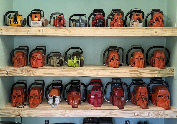

    Not really the bench, but rather shelves. All saws are unpacked in their new shop home, spoiled rotten with conditioned air and heat.

    Nice 45 caliber on the middle shelf on the far left ;)
  20. The Wood Wolverine
    18,970
    122,466
