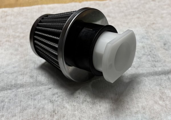

    Stuff happened, long story short now I’m going to run a… let’s say “unbranded” velocity stack.

    Looks like you have been hanging out with eggshooterest , LOL.
    The home of " Everything gets a velocity stack"
    That fancy adapter must be some of your work.
  10. Eric Wanderweg
    8,697
    69,138
    I may have sought his counsel about velocity stacks earlier this week :whistle: Delrin is easy for me to come by and should hold up.

    Is it a straight shot down the i.d. or did you put taper down to the carb throat size? Assuming you machined it yourself.
  13. Eric Wanderweg
    8,697
    69,138
    It’s got a slight taper in it from where it mounts to the carburetor elbow, up to the I.D. of the filter. It all matches up reasonably well.

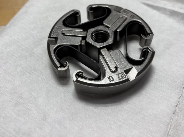

    I wonder if there’s a market for this? Converting new fine thread clutches to coarse thread. The original clutch on the 61 was very questionable, so this is cheap insurance.

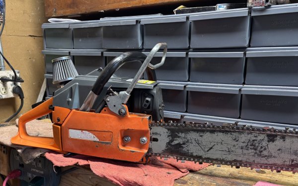

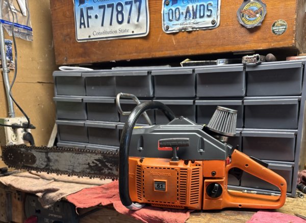

  19. Eric Wanderweg
    8,697
    69,138
    The 61/272 is mostly complete. I got it fired up but didn’t run it too long, because there’s no bar oil in it. I’m waiting to get the correct oil cap. With the older side cover and steel chain brake I didn’t have the space to use a decomp. Once that ring seats it should be fun to pull over :cool:

    Don't forget to oil the filter.
