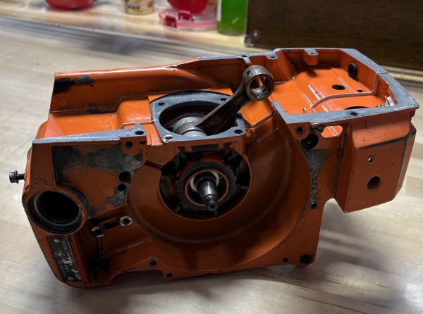

    Now that the 61 project is complete, it’s time to get back to rebuilding this basket case 288 I got off eBay.
    Splitting cases is a breeze now that I’ve done it a couple times.
    The cylinder is ready, I have the new piston/ring, gasket kit, bearings and seals, so hopefully within a week or two working on it here and there I can get it back together.

    The stressful part (for me) is done. It’s great having access to dry ice :whistle: The crank spins really nice. I’ll continue with the build tomorrow.
    A couple things I overlooked that I needed for this saw:
    A muffler and a flywheel. The muffler that was on it was hacked up and dented badly, not worth salvaging IMO. I ordered a cheap $20 replacement. The flywheel had a large chunk missing on one of the fins which would have put it way off balance. I found an OEM flywheel on eBay for $40 so I went with that. So next week will be the earliest I can fire it up. In the meantime there’s plenty more I can work on.

    This 288 I just assembled the cases for will get started next week, as long as I didn’t miss anything else and my parts arrive in a timely manner. I debated powder coat and plastic dye, but my powder coat guy has a baby on the way and is in the nesting stage now. I don’t want to throw another chore at him. So the 288 will have sort of a beat up rat rod look once assembled. It’ll be mechanically sound, which is all I want from a work saw.

    Miserable weather here so I put in some time on the 288 this evening. I’m still waiting for the new used OEM flywheel and aftermarket muffler, but good progress was made tonight. It never ceases to amaze me how fast these actually come together. A Meteor piston, Caber ring, and base gasket delete with Motoseal.
