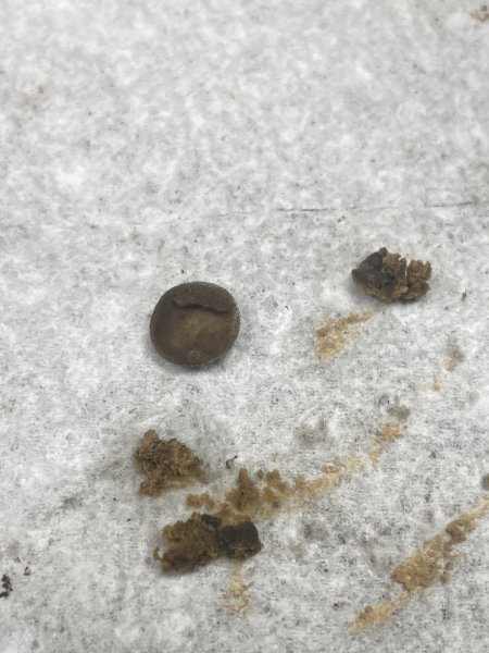

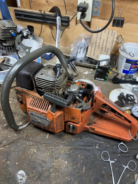

    An air leak is one way to lean out a saw. Took care of that. It was minor at that on the vacuum side.
    On the put back I went through the brand new looking AM carb first. Hoping this was the major issue.

    someday I might smarten up and look there first!

    That's due to a lack of replacing the fuel filter regularly, right? Or perhaps a fuel filter that popped off. Is cleaning out a carb something that should be done on a schedule or realistically do most people just run them until something like this happens and then clean them?

    There’s no hard fast rule, but typically it’s from when the fuel filter falls off or breaks off the line inside the tank and the saw continues to suck everything from the gas tank into the carburetor. But Mike had it happen on a brand new 572 with everything still intact

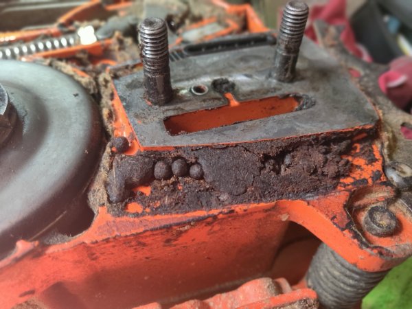

    I had some sawdust/bar oil coco puffs when I opened up a donor saw's protector plate on a 372xp today. Heh heh. Never seen those before!! Hahahaha.

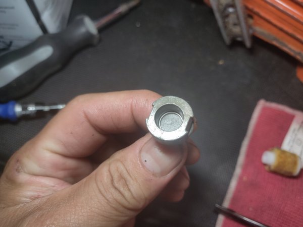

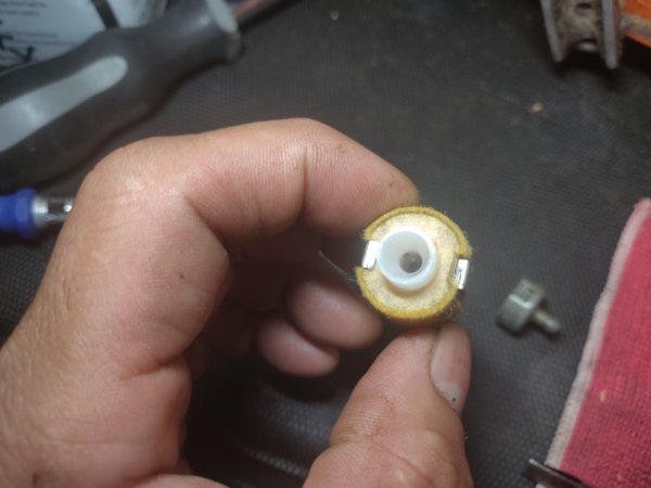

    Gotcha. Wow that's weird. I guess it's cheap insurance to buy a bunch of extra filters. Which filter do you like to use? I ordered a bunch of new ones that look like this for the 372xp rebuilds.
    I like that you can open them up and clear them out without having to just replace them. Plus they have some heft to them and will help the filter follow the fuel when the tank is low.

    That’s mostly what I use. Designed by Walbro I believe. They come standard on some new Echo saws

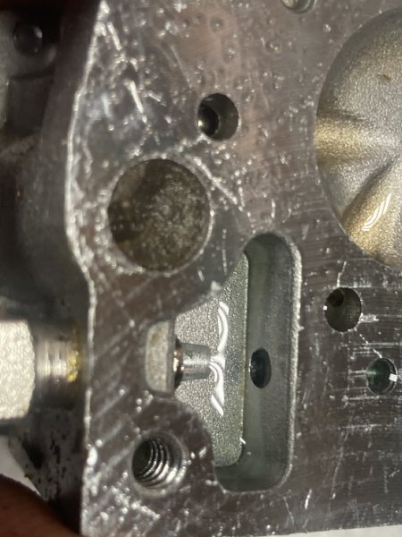

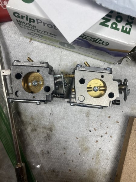

    That schmootz wasn’t helping anything, but a full clean and rebuild didn’t it get it to where it should be.
    Gave up on a repair and ordered the OEM tilly HS 181C.
    Made all the difference
    here’s the aftermarket next to the tilly.
    Two things immediately
    The hole that looks like an impulse is, but isn’t, ( I guess it’s a machining aid) is much further away from the barrel. Helps eliminate air leak if the gasket isn’t right on.
    The other is the volute size and geometry. OEM is way more pronounced.
    I generally have pretty good luck with the aftermarket carbs, but not this time. Saw came to me with this am carb.

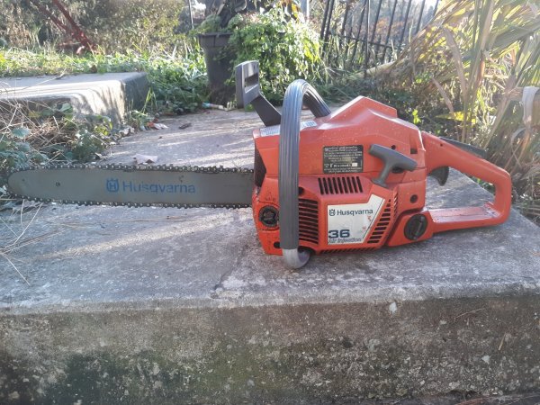

    20211106_165602.jpg This old husky 36 followed me home yesterday. Runs but seems to leak fuel around the carb somewhere. I guess I'll start with fuel lines and go from there.

    I blacked out a 136. Impressive they are not, but light as heck they are.

    This saw weighs as much as my 490 echo and gives up 15cc in displacement.

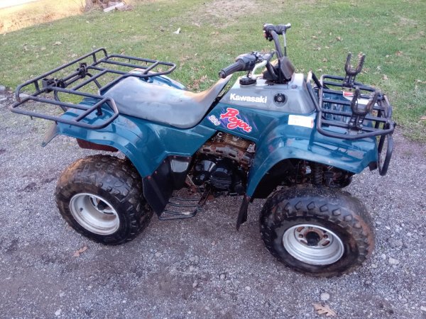

    Someone swapped out the original wheels and tires.
    It had only been ridden a few times
    Since he bought it new
    He only rode it a few times.
    Cleaned the carb and tank
    Oil change and a new battery
    It's like new for my nieces and nephews.

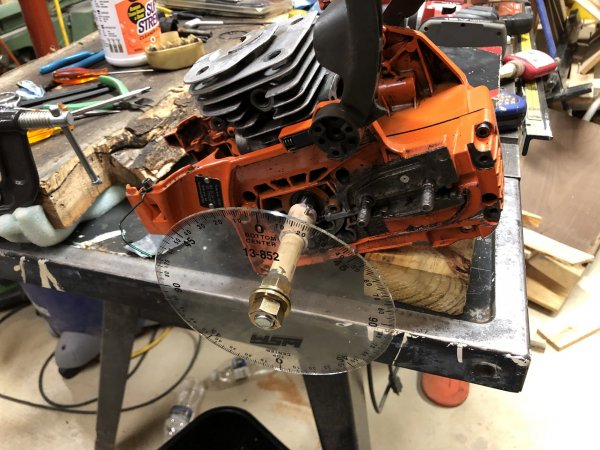

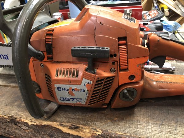

    Husky 357 getting fully torn down and all wear items replaced or dressed up. It will get a little surgery from the rotary grinder as well...
    A little wire and J-B Weld will keep the cover cracks from getting any worse. Won't be pretty, but it's a work saw, not a museum piece.
    Checking the timing and making a plan.
    Splitting the case to replace bearings and seals. Lower transfers will get matched to case halves and opened up for better flow.

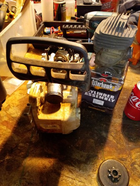

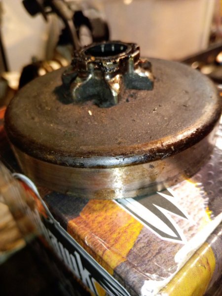

    The son read on Facebook you can
    Use 290/390 cylinders on it
    You cannot they don't fit and different impulse as well. IMG_20211130_174131.jpg
    I asked why he didn't take it to the dealer
    Here's a 046 sprocket he ran
    He obviously doesn't maintain his equipment.
