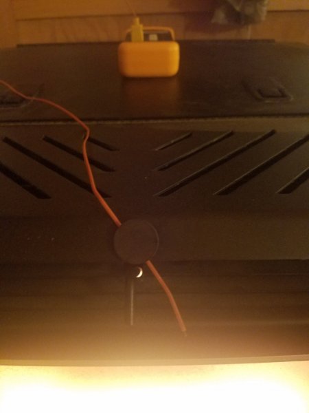

    Anywhere in the vacinity of the convection tube exit will suffice. The idea is to be consistent in your method. That way you can have a good comparison from pellet to pellet.
    Here is what I do:

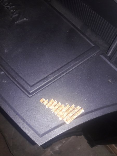

    Ok I have Purcells in da hopper. I am not measuring the heat objectively yet (if ever) but I can report a few things. The Purcell pellet is not the same pellet as the North Idaho pellet based on color alone. Purcell is darker and does seem to shoot off quite a bit more embers/sparks than Olympus or BM. Strong smell of fir. They do provide good heat but --- and this is based on feel only -- they don't seem quite as hot as Olympus or BM. But they are pretty respectable.
    Here are some pellets. There are some long cuts... maybe an inch and a quarter or more. I will measure later.

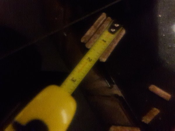

    There are some big boys here. Almost 1 and 3/4.

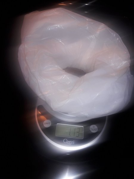

    Ok. I scooped most of the residue out of the burn pot and into the ash pan where i then smothered and dumped into a plastic bag. I calculated the bag weight into the scale prior to so the value on the scale is the REAL ash weight.
    I've got 1.13 ounces for 1 pellet bag.
    Wife says there was noticeably less fines with these than Olympus or Bear Mountain. We also agree these pellets had ash volume equivalent to Olympus and less than BM.

    About .18% ash

    Olympus (a.k.a. Sierra Supreme, Cascade) or Bear Mountain or...? I've got 2 more bags of Purcell -- I'll try to get a second reading later this week. Oh and did I do it right? I figured all that stuff left over in the burn pot qualifies as 'ash' because it came from the sole bag and just hadn't pushed out yet into the ash pan. I'm guessing those of you with similar burn pot stoves do the same thing.
