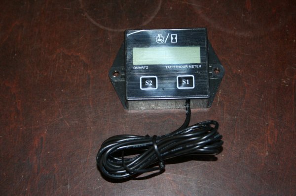

    Came today in the mailbox.
    It's supposed to get up above 50 degrees on Saturday so I intend to install it and start the new splitter up for the first time. Had it for over three months now and it's been too cold to start. I tried it one time it got kind of warmish but the fluid was way too thick.
    It's actually smaller than I thought it would be.

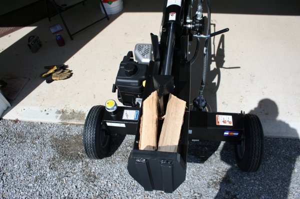

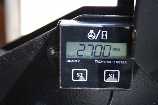

    Installed it today and after it warmed up in the afternoon I started it for the first time. I had to reset the plug firing button after it was obviously showing too high a reading on the rpm side. I let it run at moderate throttle for a few minutes and cycled the ram a few times.
    I even made a split smaller just to see it split. After I shut it off it took a gallon more of hydraulic fluid to bring it up to the max. level on the dipstick.
