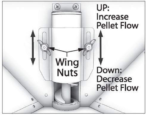

  8. jtakeman
    12,336
    55,619
    Only thing I found but different model 5710
    HOW TO ADJUST THE FUEL ADJUSTER It is a common occurrence in the pellet industry for the average pellet size to vary. Due to the varying sizes of pellets, this appliance is equipped with a fuel adjuster to adjust the amount of fuel allowed to pass into the auger assembly. The fuel adjuster is located inside the hopper. Note: The factory default setting for this is full open. To decrease the flow of pellets, move the fuel adjuster down. OPERATION INSTRUCTIONS NEVER OPERATE THIS PRODUCT WHILE UNATTENDED © 2021 United States Stove Company 11
    1. Turn off and unplug the appliance.
    2. Loosen the two wing-nuts.
    3. Adjust up to increase, or down to reduce the fuel usage based on the size of the pellets.
    4. Tighten the two wing-nuts.
