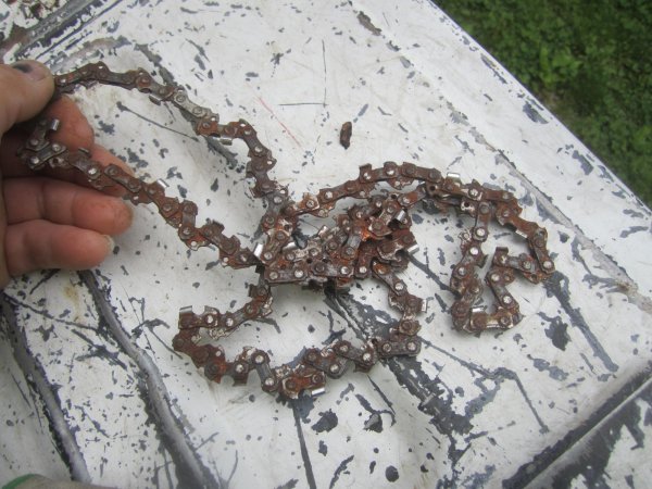

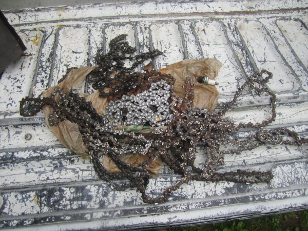

    My friends friend cuts wood for him. I do once in a while when i have time as well as give him some wood as well. Ive seen his other friend cut and its a scary thing. My friend asked if i could sharpen some chains for his friend. I obliged as he lets me store wood there. This is what i got:picard: IMG_2631.JPG IMG_2632.JPG
    A dozen chains that look like they've been used once. Some rusty, some very dull. I have some serious hand filing ahead. His friend is the type that cant be told anything either.
    I mean no disrespect, but not the sharpest tool in the shed.

    That's a nasty mess.Soak those rusty chains in a pan of auto trans fluid & they'll do a lot better. Throw away the "safety chains".

    Bingo...those guys need a good soak! I've used drain oil mixed with diesel or kerosene before too...let them soak then work them around a little, then soak some more...rinse and repeat as needed.

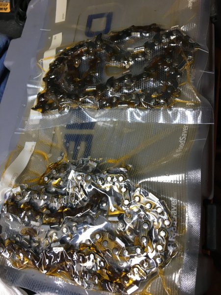

    Might not be very cost effective in the long run but when I get a loop or two like that, I put them in a plastic freezer bags with PB blaster. Then draw as much air out as I can with the vacuum sealer and not suck liquid which prevents the sealing. I let em sit like that for a week or so.
