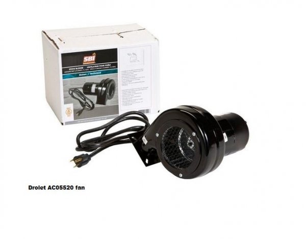

    Depending on the heat shield design, this may be an easy project. Here are photos of a plug-in Drolet Fan and thermodisc. The question is whether the heat shield design will effectively route air over and around the stove. If so, cut a hole in the heat shield, drill four holes for mounting bolts, done. The fan should be accessible for cleaning as the comb fins tend to accumulate dust over time and pump out less air. I have used compressed air to blast the crud off.

    I have been thinking about this project all day (yeah, it was a little quiet at work today :whistle:) The first order of business would be to block off the bottom of the rear heat shield so that blower air did not shoot out the bottom of the stove. This could be done by bolting/riveting/welding on a 45-degree plate. Next, adding some curved deflectors on the top of the heat shield would help to route blower air over the top of the stove. If possible, I would like to install the fan so that the discharge is angled upward as opposed to facing straight into the back of the stove. Lastly, if the heat shield is simply a bolt-on option, I'm not averse to doing this as the worst that could happen would be that it doesn't work well and I have to order a new heat shield. A buddy of mine does custom auto work (body, exhaust, engine etc), he has all the cool tools and he could knock this out in a flash. All of this depends on what this heat shield looks like; if there is minimal clearance between the shield and the back of the Ideal, this wouldn't work very well. I'm hoping for/banking on at least an inch or so of room.

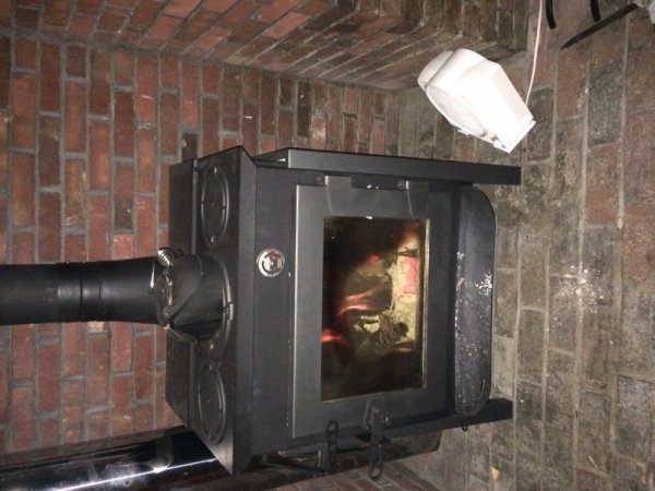

    A few thoughts for you BBar. My beta unit sits in pretty tucked in my mantle, probably not as tight as your prospective install location but its not ideal. My tiny little VC used to sit out on the hearth more and I noticed the heat got into the room better. Since I got the Ideal running I have tossed a little box fan on one side to help move the air into the room proper. I just took a few shots with my IR thermometer, the mag is on the front hotspot at about 550(565 on IR), the side with the fan is 180 the side with out is 240, the actual stove top is sitting about 360 on IR. The thermometers in the room and my own skin notice that the room heat is alot better distributed when I remember to turn on the fan( and I think the difference in the IR readings also show how much more heat I am moving off the stove).
    Growing up my parents had what I seem to recall was a scott stove. It had a simple vertical heat shield at the back with a 45 degree bend at the top, they had the bend extended and we noticed an immediate difference in how much heat we were feeling in the room versus headed up toward the ceiling.
    Bottom line I really like my beta unit, but if I get a production model I will be looking long and hard at my install and would be very tempted to rig up some type of blower arrangement or modify the heat shield. to help move the heat out into the room. I am curious to see what the heat shield would look like.

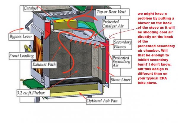

    Folks, my fan idea my have just gone out the window. Here is a screenshot of the Ideal design that was posted on Woodstock's site. If you look at the back of the stove, that is where the "preheated secondary air" chamber is. The heat shield would ostensibly mount behind this, and if we were to put a fan blasting cool air onto the back of the secondary air chamber, I have concerns that this could interfere with the burn. There is always the option to get an external fan and the Drolet thermodisc kit to activate it....not an "all in one" solution, but it would probably work.
    BrowningBAR likes this.

    I'd suggest, in another month or so when the brunt of the heating season is over, calling Woodstock and asking them for their recommendation about the best way to add a fan onto the IS. Or send an e-mail.

    My Summit blows (yes it does) air on the channel for the secondary air which I think is a poor design.
    Thin hi temp insulation might help, been thinking about putting some on my stove.
