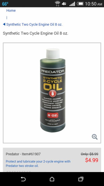

    I have a bottle coming on the mail, Has anybody tried this:

    Is that the stuff sold by Harbor Freight for like $5 a bottle?

    Yep, I am not a heavy user so I buy whatever is there when I need it. I have never seen it before so I figured I would throw it out there.

    I looked that stuff on on HF site. It lists it as $5. Thats $20 a quart! :eek:
    I can almost have a whole quart of amsoil delivered to my door for that!!
    That bottle only makes two gallon @32:1 .
    This weekend alone the little cutting i did i burned a bit over a gallon of mix!
